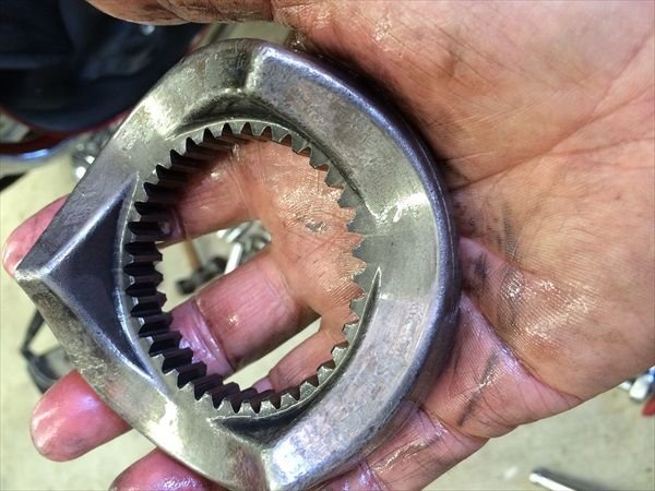

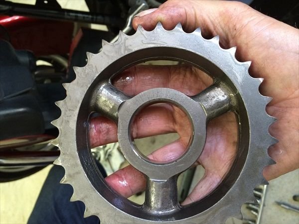

Jim, you are correct about the cruising RPM. Like I said highway cruising especially with a bagger loaded and 2 up works the hell out of the compensator. Yes lugging does also, but highway speeds at those steady RPMs and pulsing away for hours at a time, the worst. Here are a couple of pics(no not modified in any way) of a 08A comp we inspected after well over 45,000 miles and it has been getting oil. This is from a bagger with a sidecar most of the miles were loaded full and 2 up with a ton of cross country running.
