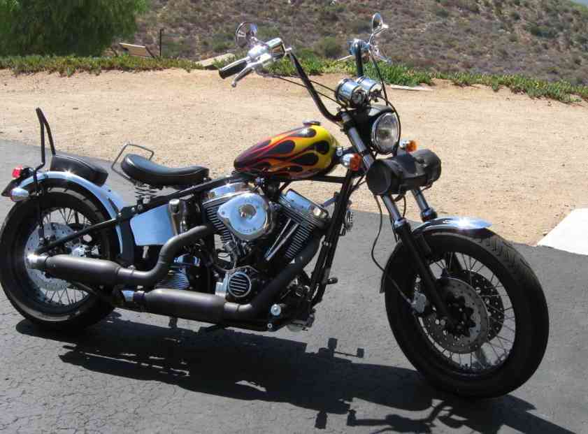

I have a 113 ci evo with pretty high compression and no comp, 3 inch belt drive.. I've had dimples pull out of steel rims in the rear, busted 3 sets of fenders, replaced as many taillights, on about my 7th speedo, 5th tach, and a dozen bulbs plus a bunch of other issues. Light bike. Would it be less of an issue with a comp? I would think so.
