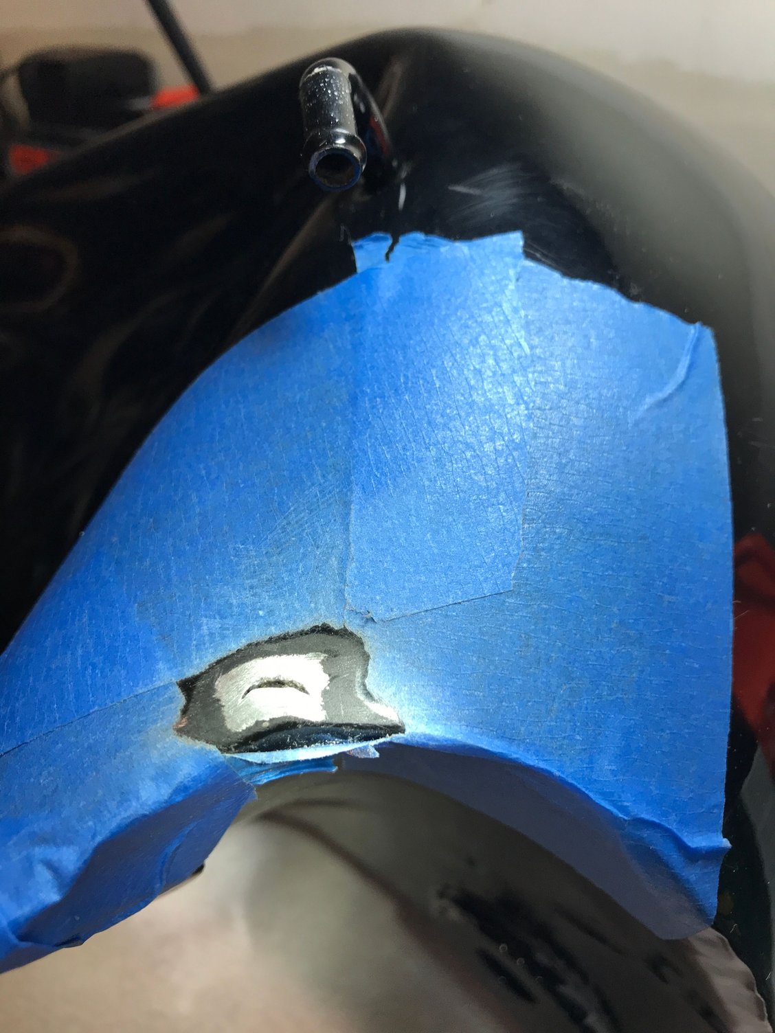

Thanks for the advice brothers. I know pic is huge but wanted to show detail. For orientation breach is it located on lowest inside corner just outboard of mounting flange of rightside tank. I got down to metal with Dremel and stopped when I realized it may be the seam of two pieces. When i probed inside that gap I can pick out some non-metal material which I can't identify.

Don`t try to braze it yourself unless you have the skills, especially with the thin tank material. It is too easy to burn a larger hole and make it even more difficult to fix it. Good heat control is imperative.
