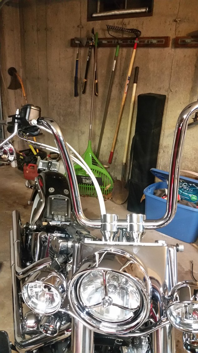

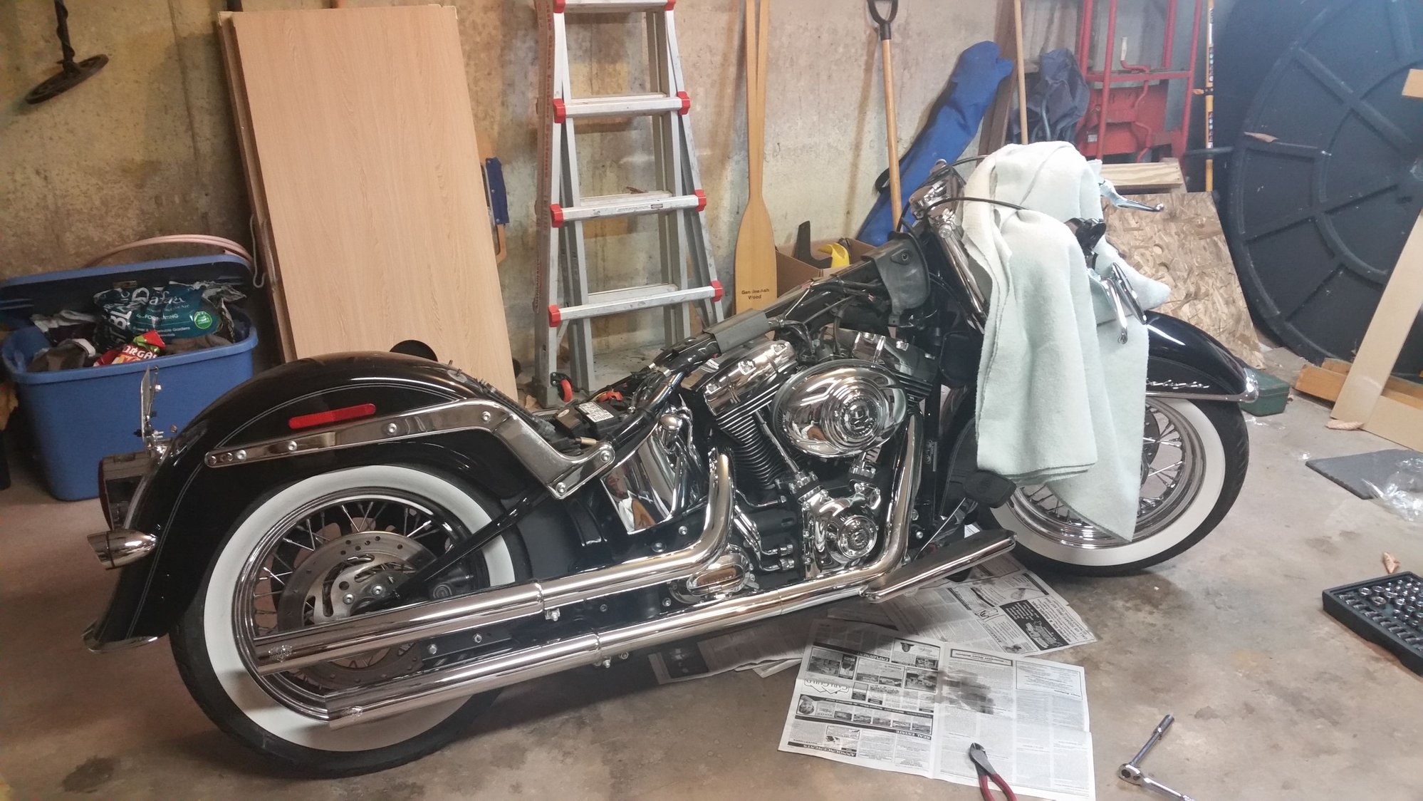

Well, I got everything off, now to solder up the new wires and get all the new stuff on. I did end up with gas all over the place, really dumb design with that crossover tube. Not sure how anyone could get to those plugs with out taking the tank off.

Guitar strings make great fish lines. I always take the tank off,paint jobs are expensive compared to an extra 15 minutes to drain the tank and clip the clamps.

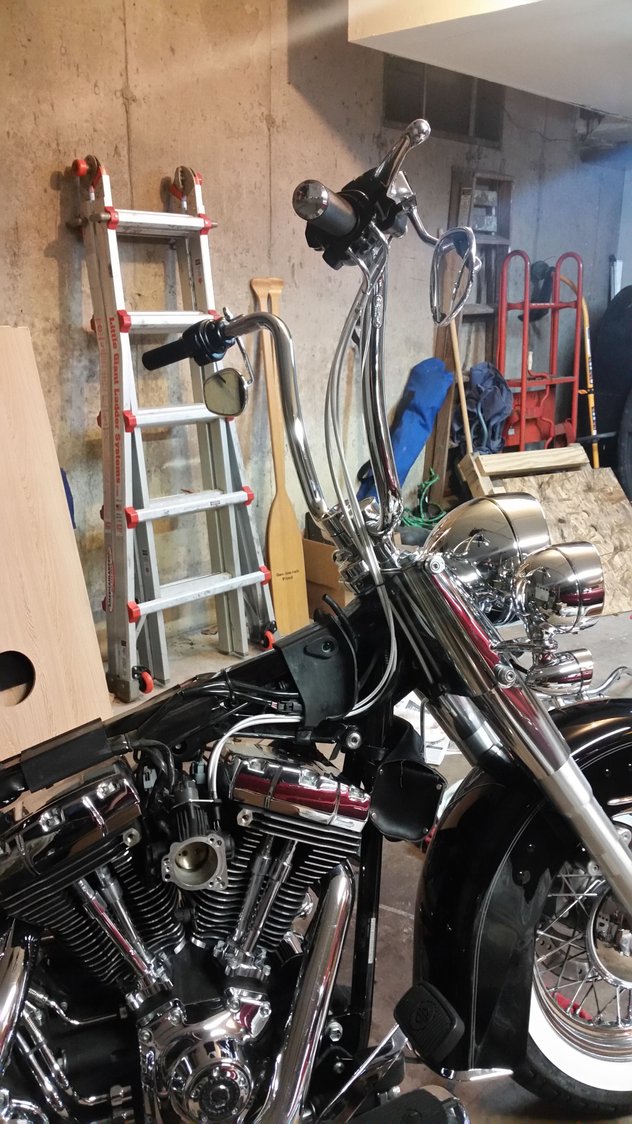

I got the wiring kit that you pull out the pins from the plug that is under the seat, cut the old pins off, solder new longer wires, crimp the new pins on the new, longer wires. Then re pin the oem plug. Heat shrink the solder joints and then heat shrink all the wires together with one big shrink. I'm in no rush and it worked great. Came out perfect. I do a lot of soldering so I don't mind it.

Got my throttle cable, idol cable and front brake line ran. Should be able to do the clutch cable and bleed the front brake tomorrow.
