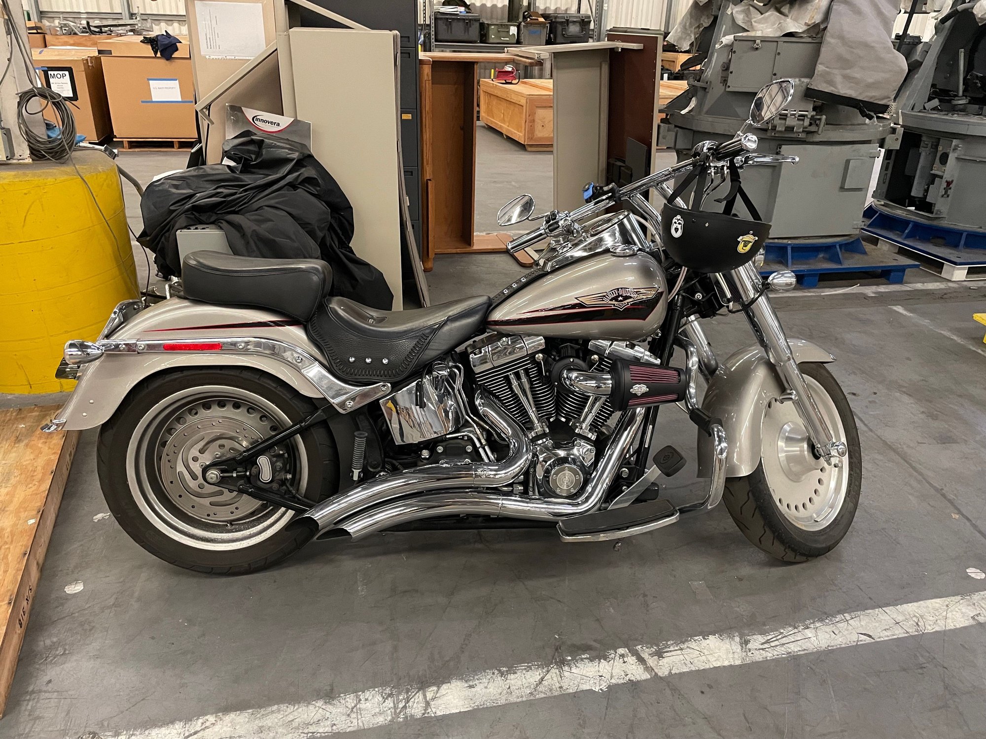

So I replaced the CKP with new, plugged PC back in then checked DIAG to make sure there were no codes present and tried to start, she turned over but would not start. A quick DIAG check showed yet again 1016 but the other 2 codes ( P0261/P0263) were gone as MyFavRK figure would happen. So far I have changed the CKP, the fuel filter, fuel regulator, fuel pump, and check valve assy. What am I missing? Any thoughts?

Well, I gave up and will take her to Harley tomorrow to see if they can fix it. Between getting stuck overseas for months at a time, going back again in a few days for longer there is just isn't time for me to TS and try to find out what's wrong. Plus I am fairly frustrated and no idea what's wrong. I have checked and rechecked the issues and followed advice but nothing seems to work. I cringe at the thought of how much I am going to be charged to troubleshoot and fix but am crossing fingers for a good mechanic that knows his ****

Well a bit late updating this but what the hell. Harley did fix the problem (s). Cost an arm and a leg but she runs well now though needs a tune. It was a combo of many problems according to them; clutch basket, starter, fuel delivery, plugs, plug wires, bad PC throwing codes. Have a Vance and Hines exhaust with VH VO2 air cleaner and VH fuel pak, I have it set per directions but its fairly generic setting and she runs rich, also wondering if previous owner changed sprocket out as 1st gear seems pretty damn high
