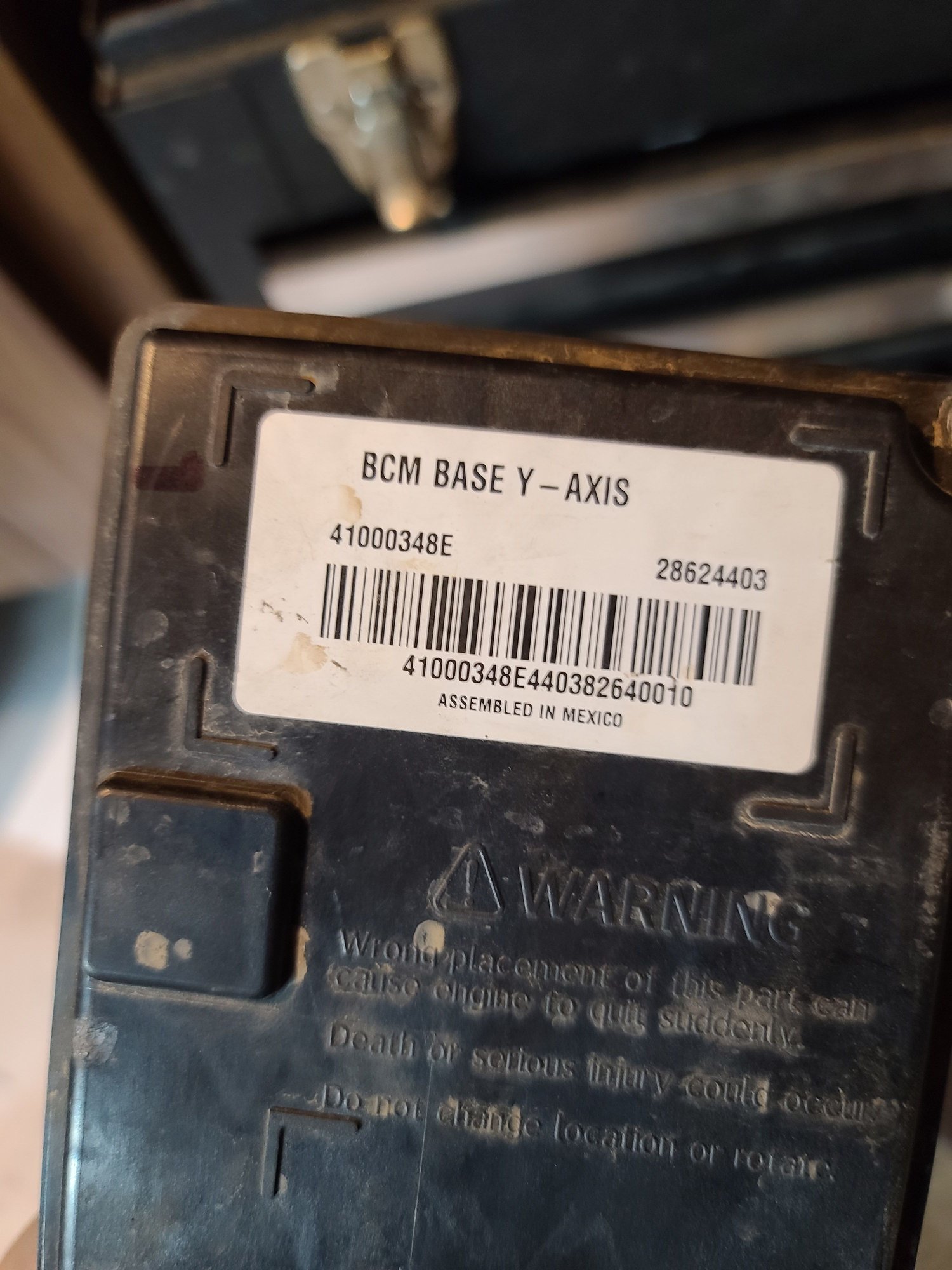

42.1k miles bike basically has a disco party on the dash but still runs. Dealership says now it's the speedo so I replaced that.
60k miles bike shuts off again randomly and won't start. Has weird code (pictured below) was on dash and wouldn't restart. Dealer says ecu this time. Replaced it, 2nd time riding it my daughter's vest popped the zipper on hwy, go to pull over and hit hazards and bike dies. Disconnected battery power for 5 min reconnect and bike comes back on. 2 days later we are riding again and this time red light on dash comes on and bike dies for half a second and comes back on. Did this 5 times and then died and started flashed on the dash again. This time battery disconnect worked once and then bike did red light again and died for good. Messed with it for hours, ended up throwing a new battery in and bike fired and got home. Upon inspection of bcm is it very loosely mounted. Enough to where rock shield and bcm are rubbing on each other and wearing on it. It's also extremely loose in the bracketry. Alot of schematics and exploded views show security and abs (I have neither) but the bcm literally slaps back and forth 1/8 in bracketery. Don't see any cracked or bad wires. Connectors look decent. I think dealer put wrong bcm in from start. See pic below for what they put in.

That is the correct BCM for your bike in 2018... now they are using the updated part #41000348F for the non-security bikes and the #41000349F for the bikes with security.
Did the dealer do and inspection/diagnostic on your bike and then do the work for each part replacement, or did you install various parts "the dealership" suggested..???
If it was a suggestion from the "dealership", who exactly were you talking to? Were you speaking with a tech who did a diagnostic check on your bike (often good advice), a service writer (often clueless), a salesman (mostly clueless), a parts guy (trying to sell a part), or the kid who washes the bikes after service (expert at putting swirl marks in paint)....???
Anything is possible, but just seems strange to me that in the course of 3 years, after 5 years of good service, a bike needed a BCM, a speedo, and an ECM.... Most bikes won't need any one of those in a lifetime and yours needed all three...??? It sounds like "the dealership" is just throwing parts at the problem instead of correctly identifying the true issue.
If the Dealership actually did an inspection and full diagnostic of your bike before each part was replaced, I would at least be looking for a new dealership.... Even if they are usually squared away, it never hurts to have a second set of eyes on a problem that you can't seem to pin down/fix...
FWIW... Since you found the BCM loosely mounted, it sounds like the first repair in 2018, was substandard.... I would be suspect of any wires, connectors, or other sensors/modules that the BCM has been "bouncing/vibrating" off of for the last 3 years as you rode, to include maybe the BCM itself... But I would do a proper diagnostic/inspection on any parts, connectors, wires BEFORE replacing them...

Would F have been the current rev for this part in 2018?
The dealership has always done the diagnostic and then told me what part they wanted to replace. After the BCM was put in, I did less than 200 miles before they next "failure" to the speedo. At that time I told the dealership very clearly in email I wanted them to inspect the bcm and the wiring rather than just keep throwing parts at it, and that they were not authorized to do any other work outside of that scope. I got a call said your bike is done. Went in and got told a new speedo has been installed and that fixed my issue. I said I wanted to talk to the shop manager. The shop manager came out I showed him the email between myself and the service writer and yes he is absolutely clueless and said who authorized you to do this work. He promptly puffed up his chest and said I don't listen to youtube mechanics this is what the diagnostic said is wrong, your bike is fixed so why are you complaining.

Inside of the rock shield
Wear marks on bcm

As for your BCM installed in 2018... I believe they probably used the current one for that time. The updated parts, as long as they have the same part number but different suffix letter, are mostly the same. The newer letter could signify anything from a running production change/upgrade to the part, to just a supplier change... The part number that they used was for a non-security bike...
There were many bikes without the security alarm or ABS and I don't believe for a second that they were shipped with a loose BCM in the bracket. I suspect something is wrong/damaged with the bracket... the parts fiche doesn't show a separate bracket between the two BCM numbers. It shows just a BCM, ECM, and then the security siren module (where applicable) in that bracket.. I suspect it was a bad install, that either led to wear/failure of the bracket or maybe the non-security BCM gets shipped with some kind of shim to allow for it to fit properly in the bracket. It is possible the bracket is still salvageable...
I believe it's possible, that the tip over sensor could be causing your problems.. There was a thread on here not long ago, where a guy couldn't get his bike to to start, and it was a broken bracket on his TSM that caused it to fall over on it's side, and the tip over sensor couldn't obviously be reset... That was with the TSSM/TSM module configurations...
I believe, that when the BCMs came into play, they took the place of the TSSM/TSM modules... I did notice there were two BSM part numbers for your bike... one for non-security and one for security... just like the TSM/TSSM modules of old...... So it stands to reason that the tip over sensor, is now part of the BCM... The old TSM/TSSM would display a message in the speedo, "tip", when the tip over sensor was tripped... maybe the BCMs show a different message/code like your "5 0" message...
