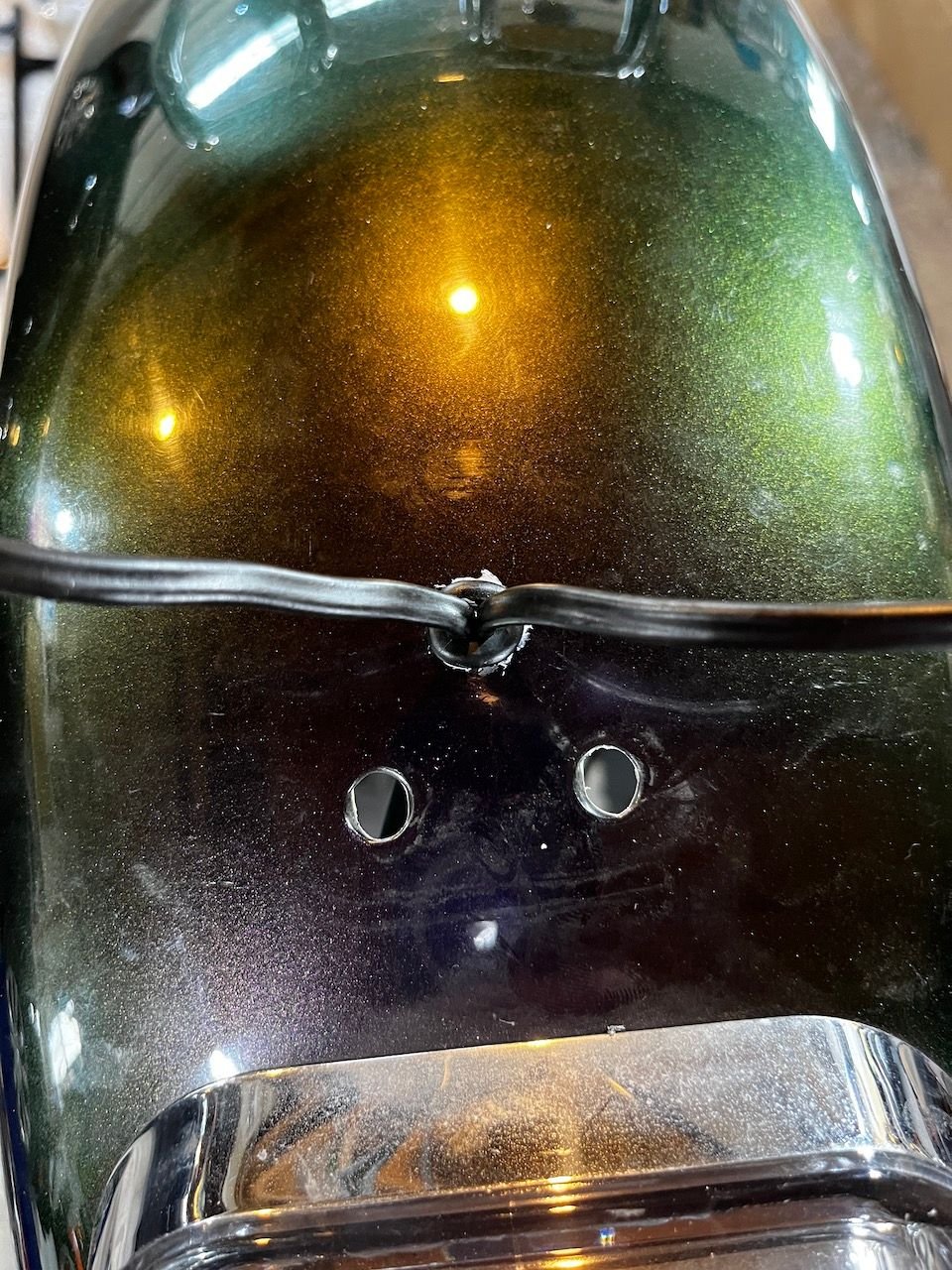

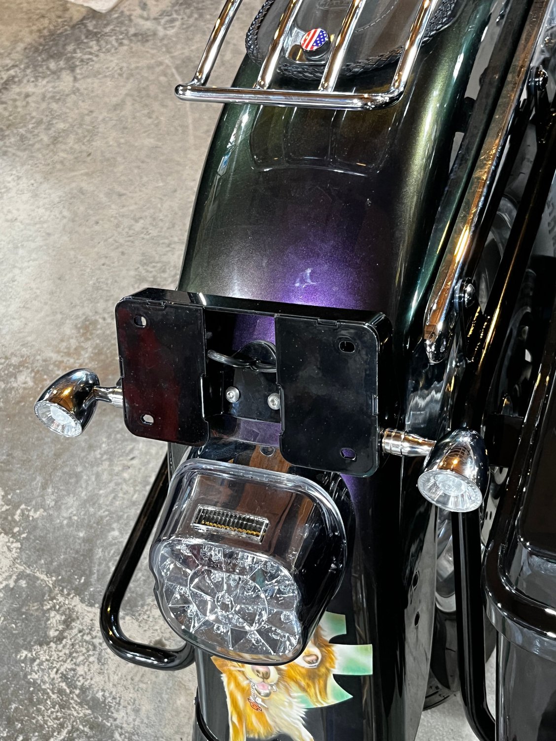

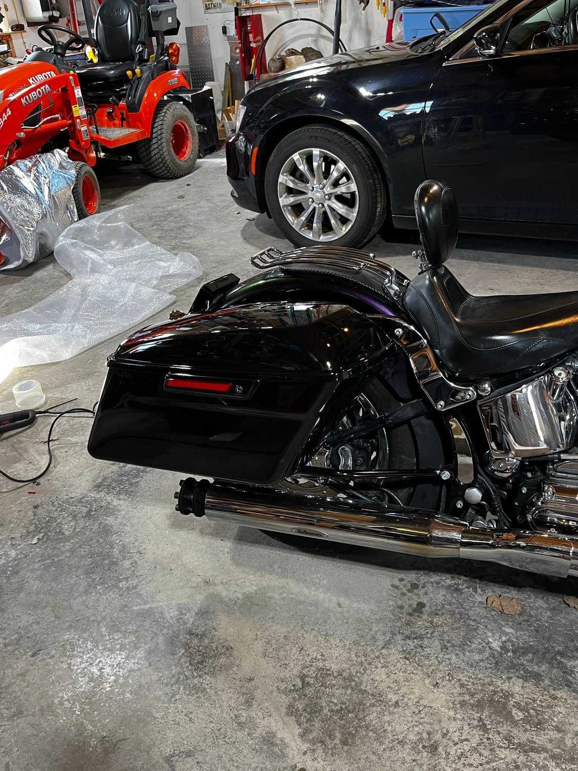

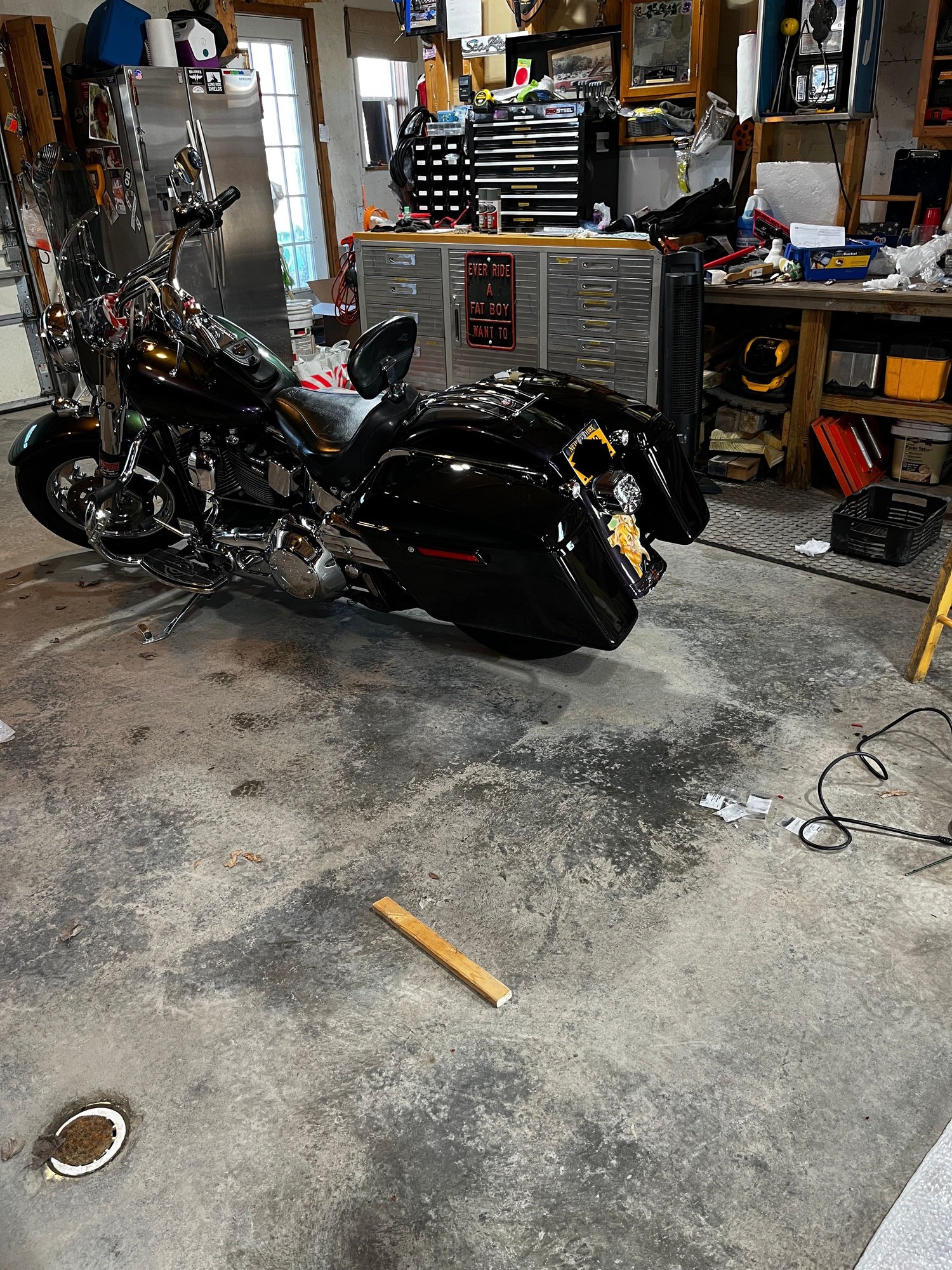

Some photos in case someone is interested in putting these bags on a Softail or more specifially a Fat Boy of this era.
1) Removed strut bolts. Loosened front 2 so that fender would swivel up without removing it.
2) Enlarged top hole and inserted grommet to feed the signal light wires through.
3) Layback license plate bracket/signal light mount from J&P Cycles installed. Note that top hole is now used for wire feed instead of third bolt for license plate frame.
4) Next 3 show bags attached to bike.
Not shown - I was able to reinstall the HD chrome teardrop toolbox ahead of the bag on the left side of the bike.

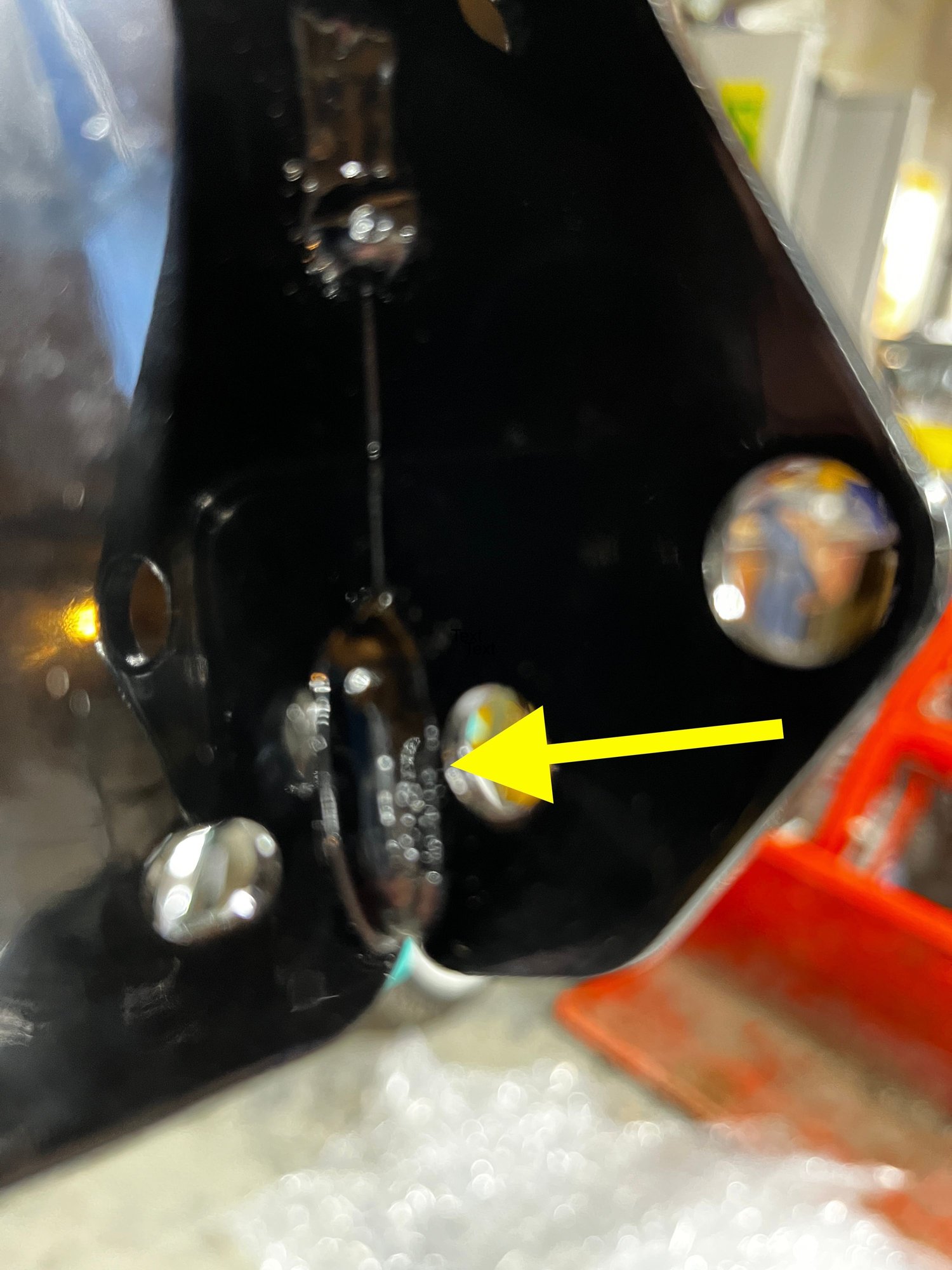

One other note. The J&P bracket had weld right up to the edge of a hole on one side. Had to grind some away so that the nut with integrated washer that holds the turn signal on would tighten flush to the bracket.
