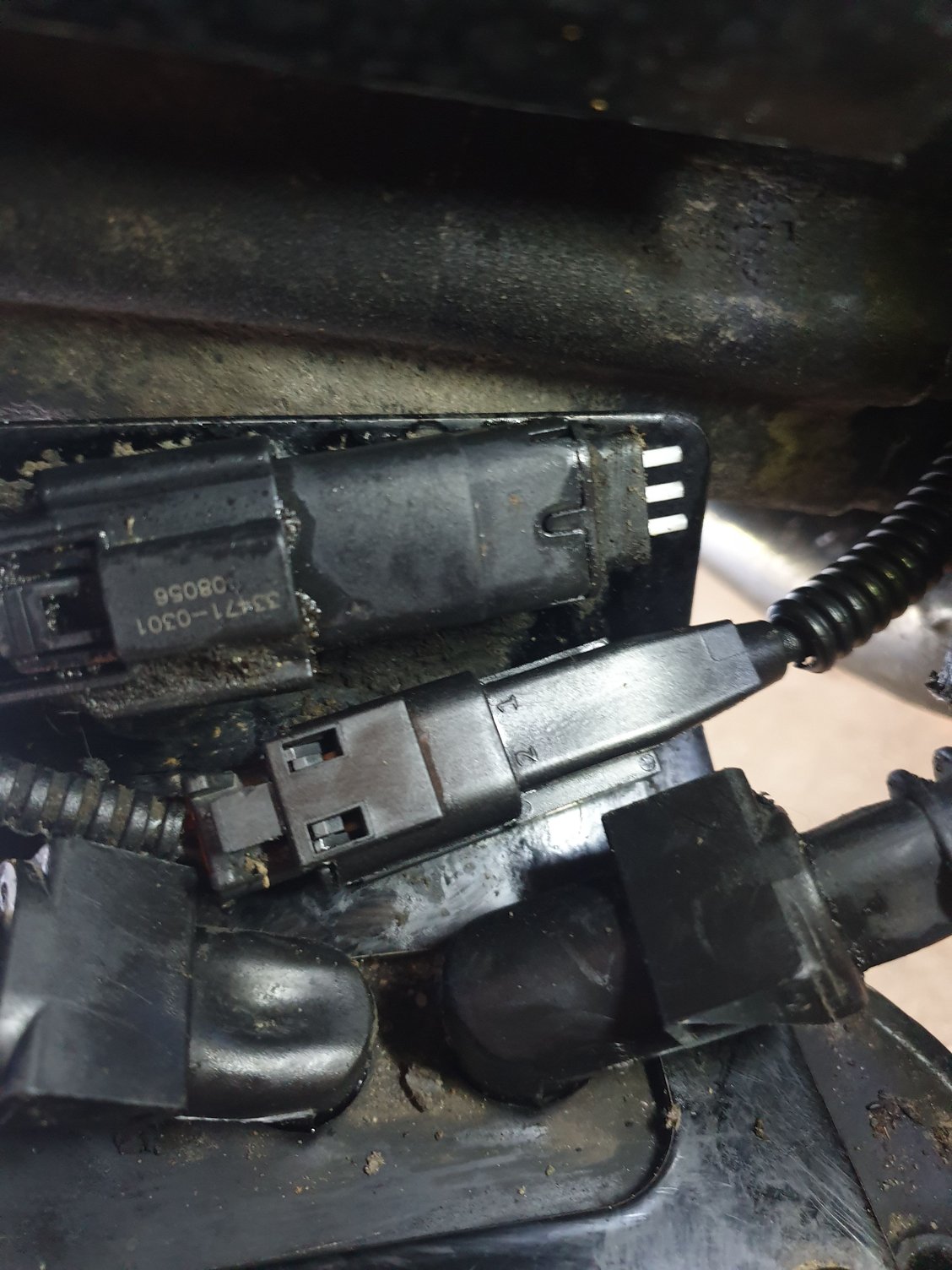

I don't want to sound too excited but I think the issue has been solved. I replaced the engine temperature sensor and it wasn't the problem but looked as though it needed changing so that made me feel a bit better.
When I replaced the crank position sensor the problem went away. I couldn't believe it. I took it for a 50 mile ride then pulled over, turned it off, opened the fuel cap (issue seemed to happen mostly at petrol stations), then hit start and it fired into life. I must have tried it a dozen more times and no problem. I will keep posting updates even if the issue doesn't come back.
To access the temperature sensor I needed to remove the horn. Upon reinstalling I heard some rattling like steel ball bearings inside. I took the horn off and rotated it to get whatever was in there out. Four or five small stones dropped out. Going for a ride afterwards I noticed that the sound of what I have always thought was the engine tappets, was no longer present!
When changing the crank position sensor I noticed another wire above it. It has three white prongs sticking out of the fitting but there is no sign of a female connection anywhere. The wire joins up to others and heads to the rear of the motorcycle. Looking up the number on it it is a NAMZ Custom Cycle Molex male connector.
Does anyone know what that is for? I have added a photo for reference. Thank you.
