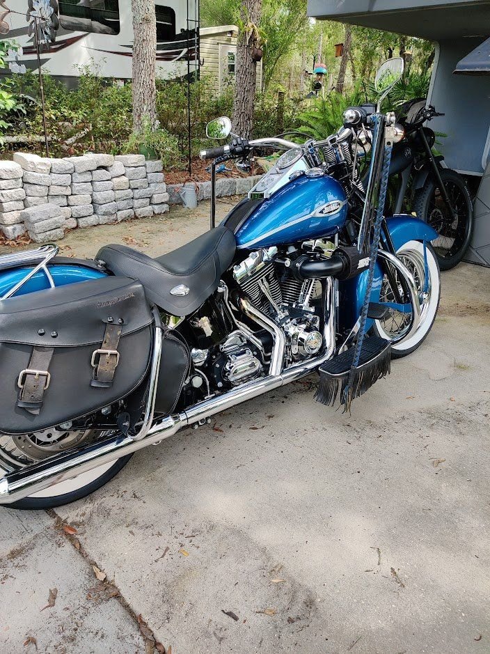

Heading out to look at an '05 Springer Softail Classic tomorrow and had a question about the springer front end.
I've always wanted a springer, and this may be my chance, but I was looking at the photos and I wanted to ask if anyone here saw anything I should be aware of when inspecting the front end. I know springers need occasional maintenance, and the owner says he's had the bike since new. So, he should know if any maintenance has been done. But how do I find out if the front end is solid? I've watched the HD videos of the springer frontend maintenance, but is there a way to check it out on the initial ride or by looking at it? (Noob here, please be patient).
Also, look at the front end shot, does it appear that there are the right amount of spacers on the axle?
Here's an exploded view from Ronnie's.
Any information is greatly appreciated! Heading out to take a look at the bike tomorrow and would just like to know as much as possible going in. Thanks all....

Your pics look to be normal to me. I have also seen FL Springer versions with a large chrome cover that basically covers the rocker between the rigid fork and the spring fork on each side... The bike in your pics doesn't have that, it has the round cap instead, but looks correct for one without that bigger cover... but again, I've not had personal experience with the FL Springer

Good luck with the inspection... In the pics it looks like a good bike...! It will be a fun bike to ride!

Based on the pictures, that looks like a very well maintained motorcycle. I would not have too many concerns. Good luck with the purchase.

When I bought my 05' Springer Classic (lovely bikes aren't they) last fall the gent had just had the 20K check done on the forks (22k on the odo at the time). Paperwork showed no problems. I'm not sure what you would look for/at to determine if they were good. A test ride should give some indication I would think. Good luck, it's a beautiful bike.
