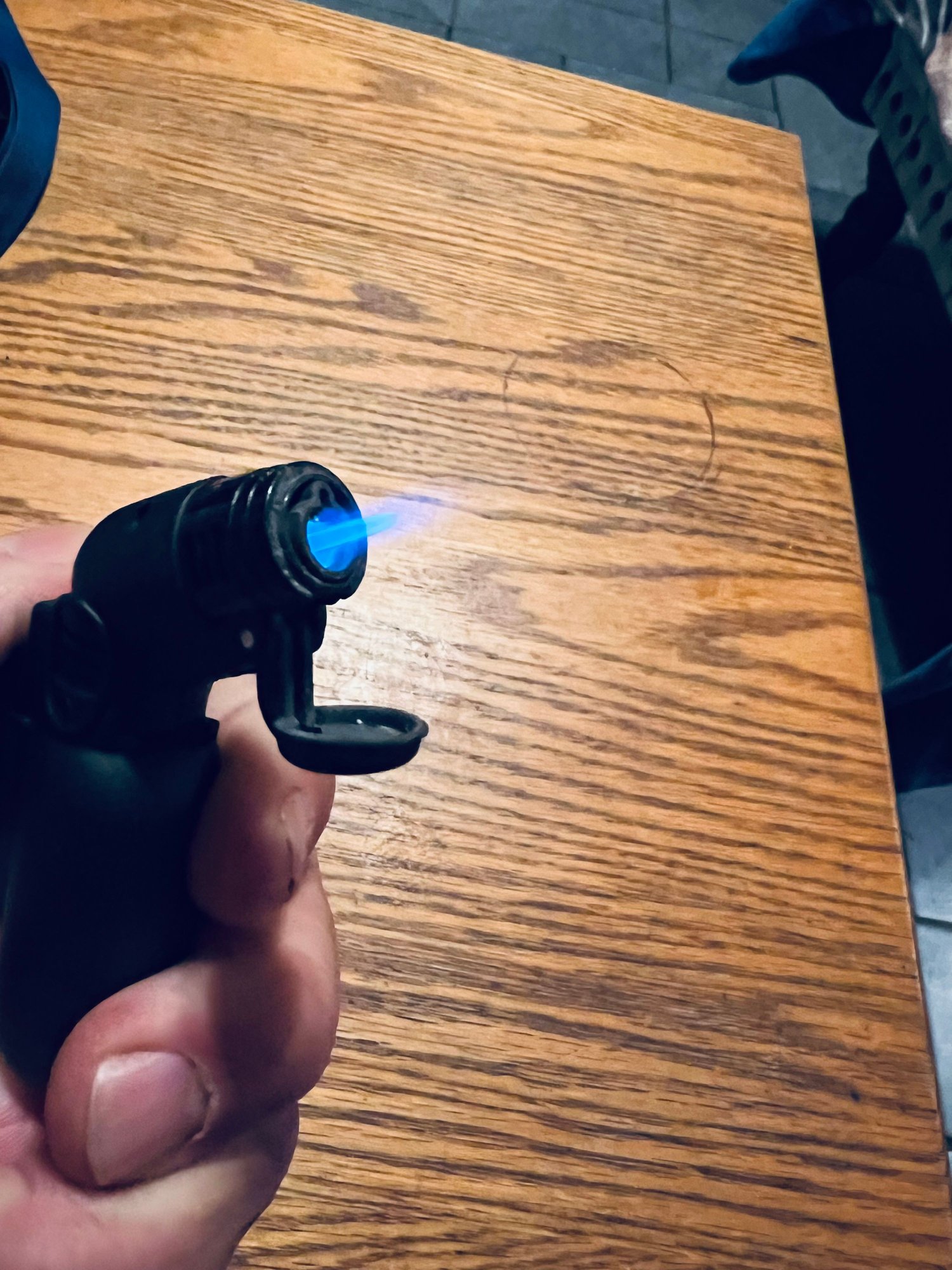

Best method of applying controlled heat in tight quarters is an angled head single burner propane cigar lighter available in many convenience stores
I will post a pic
perfect for pin point accuracy......3 bucks at 7-Eleven
