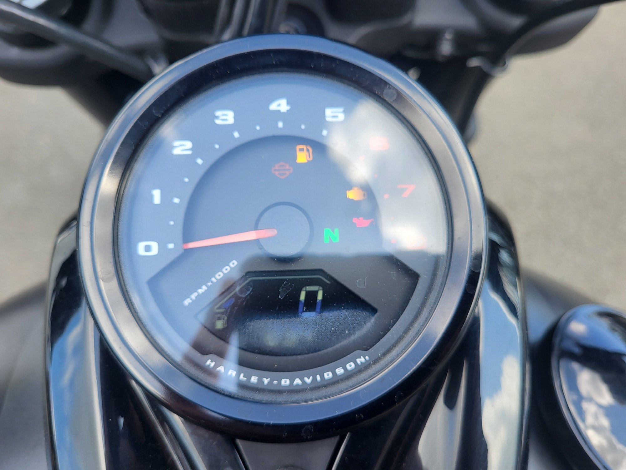

Hi....My 2018 fxfbs is having real problems with the speedometer fogging up. zSo much so that I'm struggling to even read it. Warranty company's it's water egress and that's not covered. Anyone else had similar issues. I know there's an updated part number....has that solved the prob
lem?
