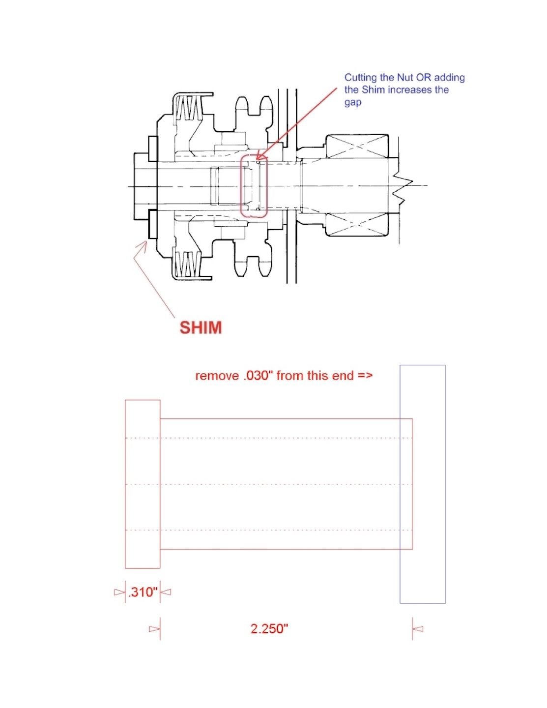

Some smart techs decided that rather than add a shim, that wasn't shown in any service manual that could lead to confusion on future comp repairs, they would trim the comp nut by .030". By cutting the comp nut, they achieved the needed spacing like adding a shim under the head of the comp nut, but it would be a permanent fix, without adding a shim that's not in the service manuals.
This is a document I saved, from a tech site I also read, about the comp nut issue and trimming the comp nut:
