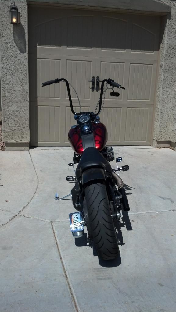

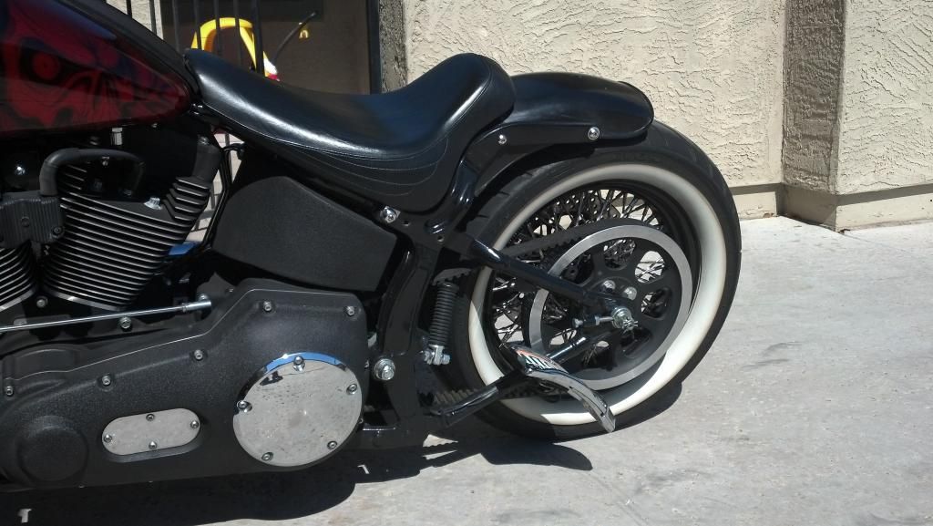

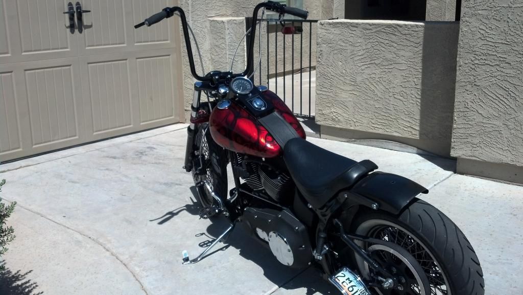

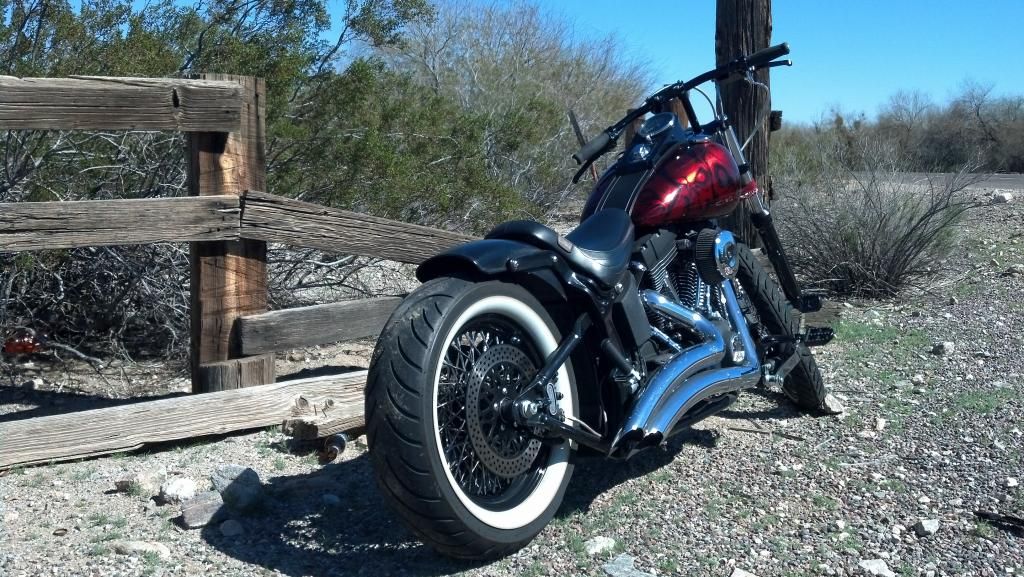

Avon 150...stock, cut rear fender.

Yea that is what I thought...please keep the photos coming
