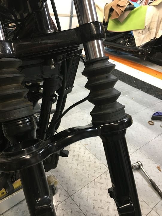

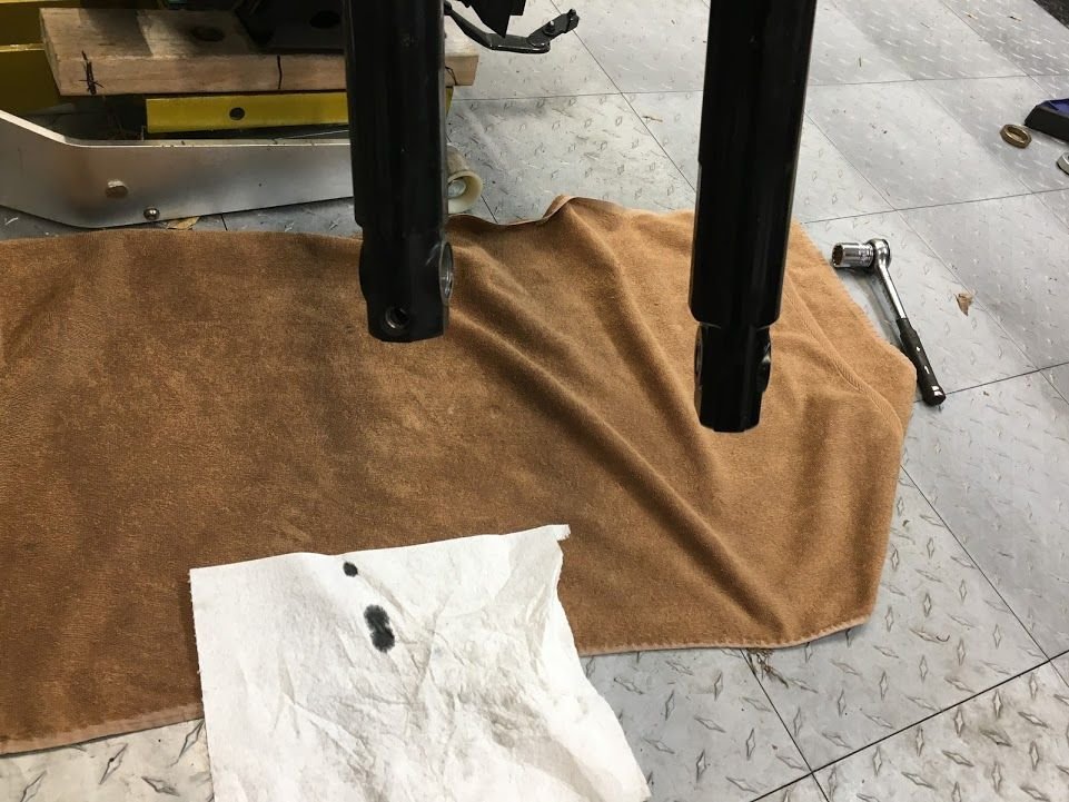

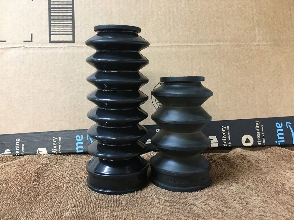

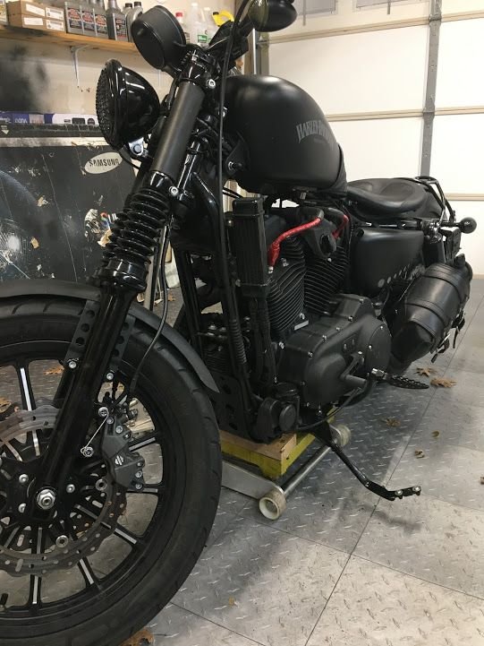

I have the Ricor Intiminators (sold by DK) and the 'R' model damper tubes. Works great for me.
Here's some pics of the difference between 'stock' Iron and 'R' tube install and the new longer gaiters
needed to match....
hth,
