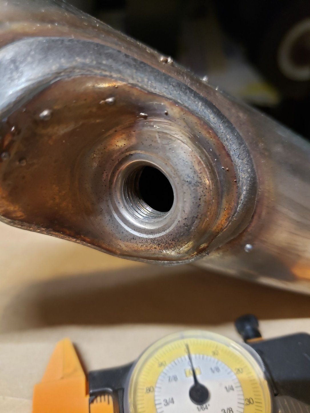

Damn! Can you get the two wire sensors in a 12 mm? I'll need to see if there's enough diameter to drill them out.

Unfortunately not enough material behind the threads to drill out and tap to 18mm. However it could be cut out and a new 18mm bung welded in, there's enough room for that. Would the 12mm work without the two heating wires attached?

Electrical isn't my forte so I don't know for sure, but sounds reasonable to me.
