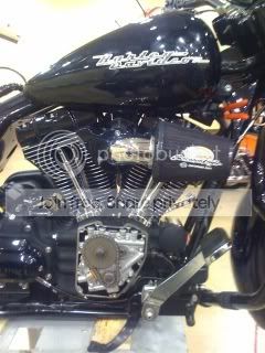

Powder is over rated and I agree 100%...you could have real nice looking covers for the price of a can of high heatpaint. Maybe 5-6 bucks.If you take your time they can look as good or better than powder for alot less $.It's easy to do,it lasts, and you can do 'em right in your garage.I did mine two years ago and they still look great.I don't have a better pic but you can kinda see 'em
[IMG]local://upfiles/36280/F87BD1C71CFA47F3A57B9448DD8BED5B.jpg[/IMG]
completely agreed, AND you don't have to bake them in any oven like the can says, just stick them back on and ride. they bake themselves haha

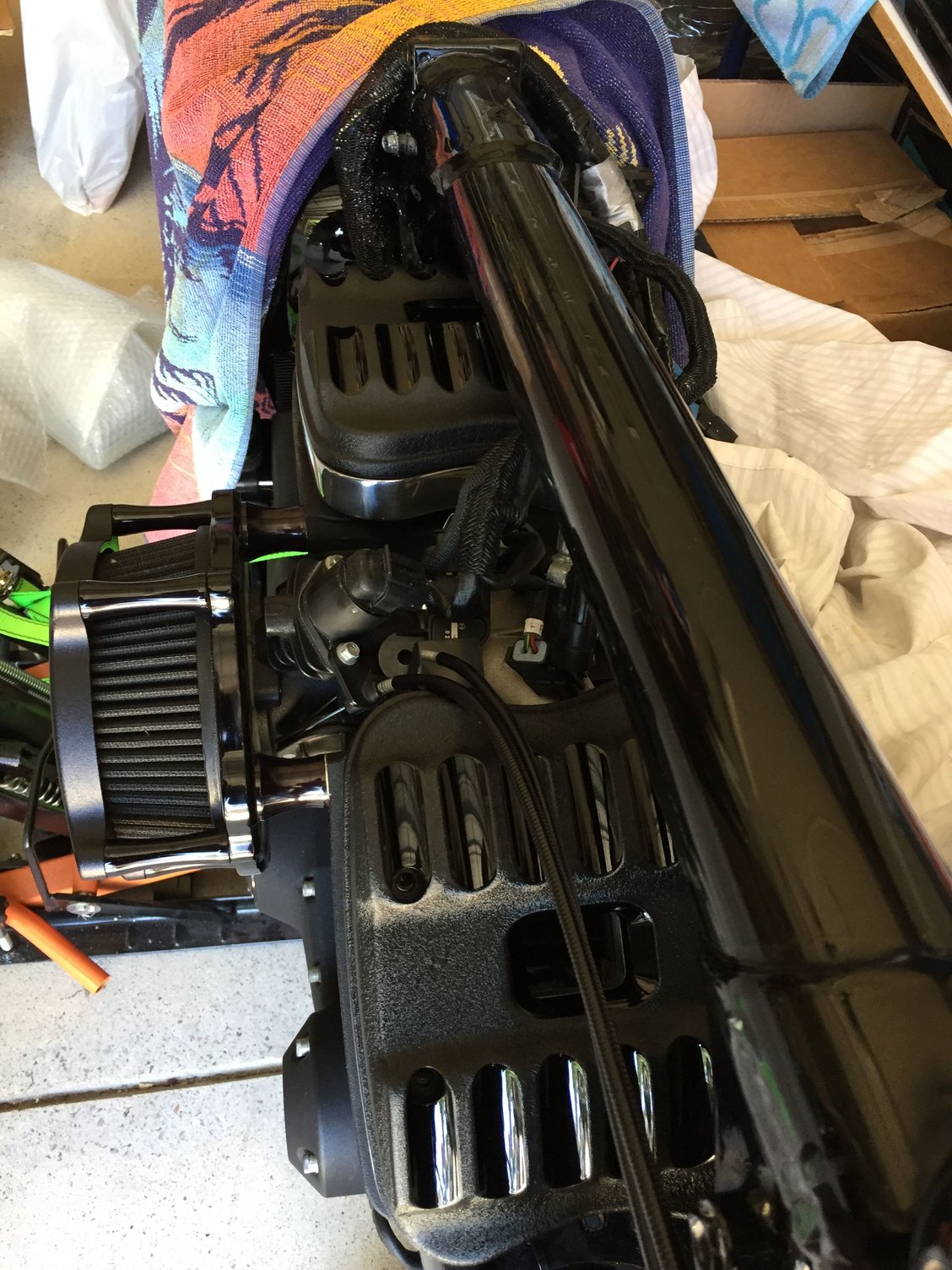

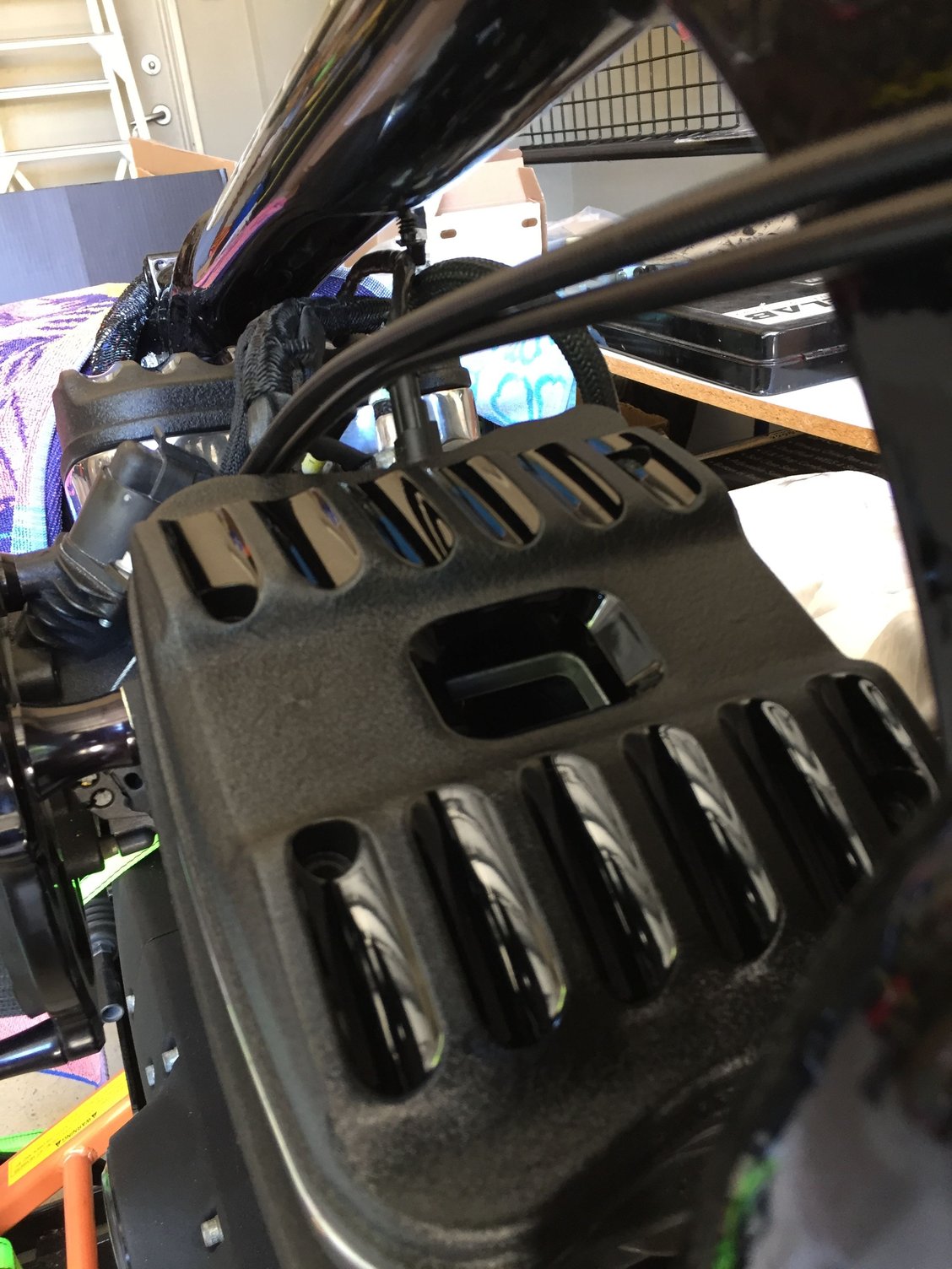

An old thread, but I will add to it with pics for those wanting ideas. Powder coated in
Texter Black with Harley Gloss Black highlights.
