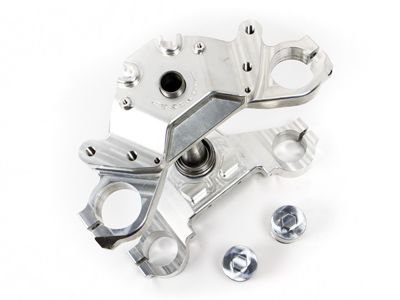

Trikes and sidecars Going the raked tree route when done right works just as well now and is a lot lower cost . For most.
You can purchase very well made Raked trees and extensions .
Hannigan does some amazing front end work mostly on BMW and GW to allow the use of a car tire on the front of their trikes and sidecar rigs.
Harley Touring bikes seems to work just fine with the right raked tree. For trikes and sidecars.
I run their machined 4 1/2 degree tree on the Twin classic rig. Same tree used on trikes..
IMO there Tree is better made and a good value compare to some of the Cheap ones I looked at in the past.
