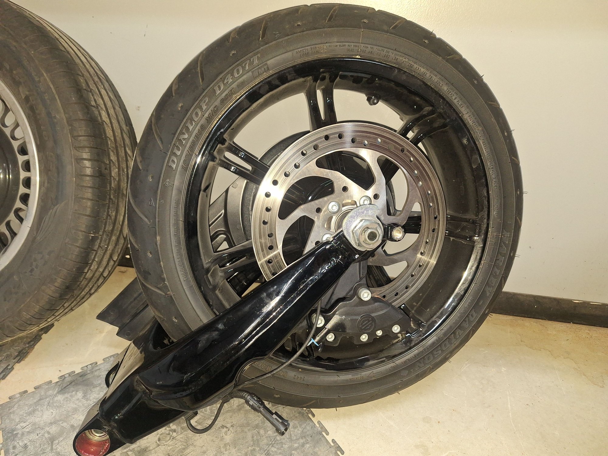

RDRS does not care TPMS willwork you need to buy or make an adapter for valve stem hole. When tire is broke down write down the serial number of your sensor . It May need to be reentered most often not a same bike swap.
16 inch wheel off an RGU or Ultra will directly replace the factory 180/55-18. Picture show one on the left that has been used on 3 different sidecar rigs as the rear bike tire.. 195/65R16 comes out to almost exact same height and width in no problem.
Car tire on rear on two wheels is up to you many do. it goes south some times.

Thank you for the reply. I had an '09 Ultra that I had a 195/60R16 Pirelli Run flat on, and I loved it. I Had no issues at all. Couple questions: what do you mean by adapter? Where does someone get one, and why is it needed? Hole smaller on the 18"? That wheel looks like it came off an "09-era bike. What brand of tire did you use successfully?
