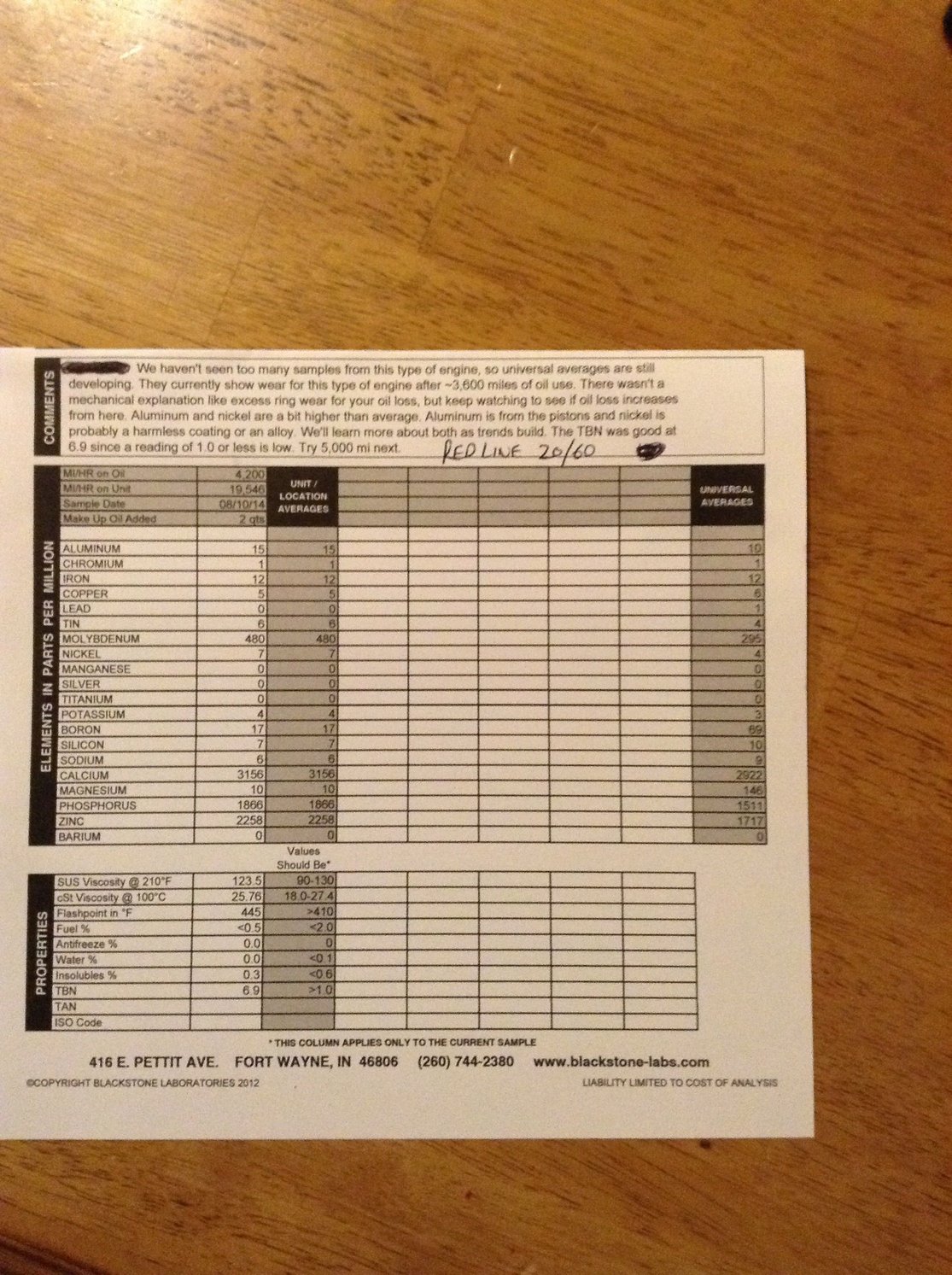

Redline 20/60
Here is the test from this summer. It was the first time I tested the oil in this motor. I used 2 quarts in a little over 4k miles. I am going to run a few more tests to see what's up
