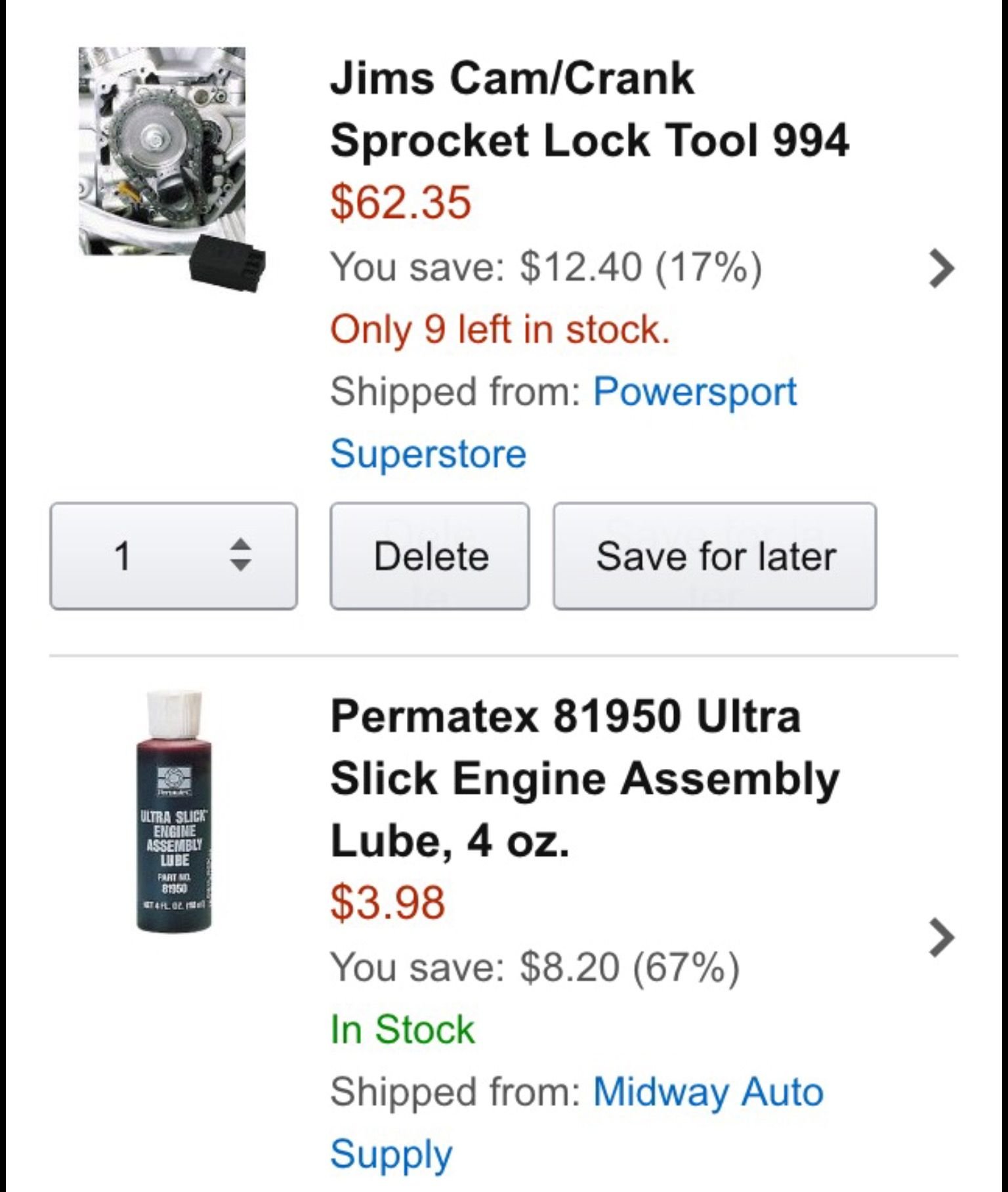

This is what I ordered and used, it worked out with no issues. The cams of your chose of course. The 14s have oil suction O-rings are tan in color, I don't know if ther diferant than the black ones but I used tan. I bought the S&S gasket and bearing kit and only used the gasket, I didn't like the bearings, you could pick a gasket up separately from HD. What ever tuner you have you could go ahead and speak to them about a base map with the cams, if it auto tunes I recommend that, save on the dyno tune and get a cheap dyno at a rally for the numbers. This is all speculative and only what I think.
