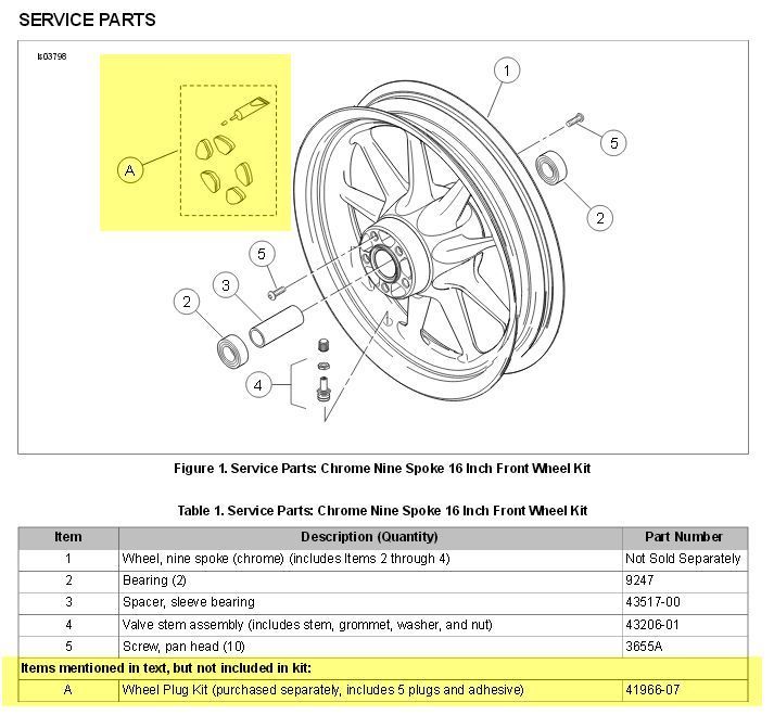

It is common for people to run them like that. There is no risk of moisture entering the wheel. But if it bothers you, the MoCo makes a wheel plug kit for that exact situation. Or use RTV as previously mentioned.
