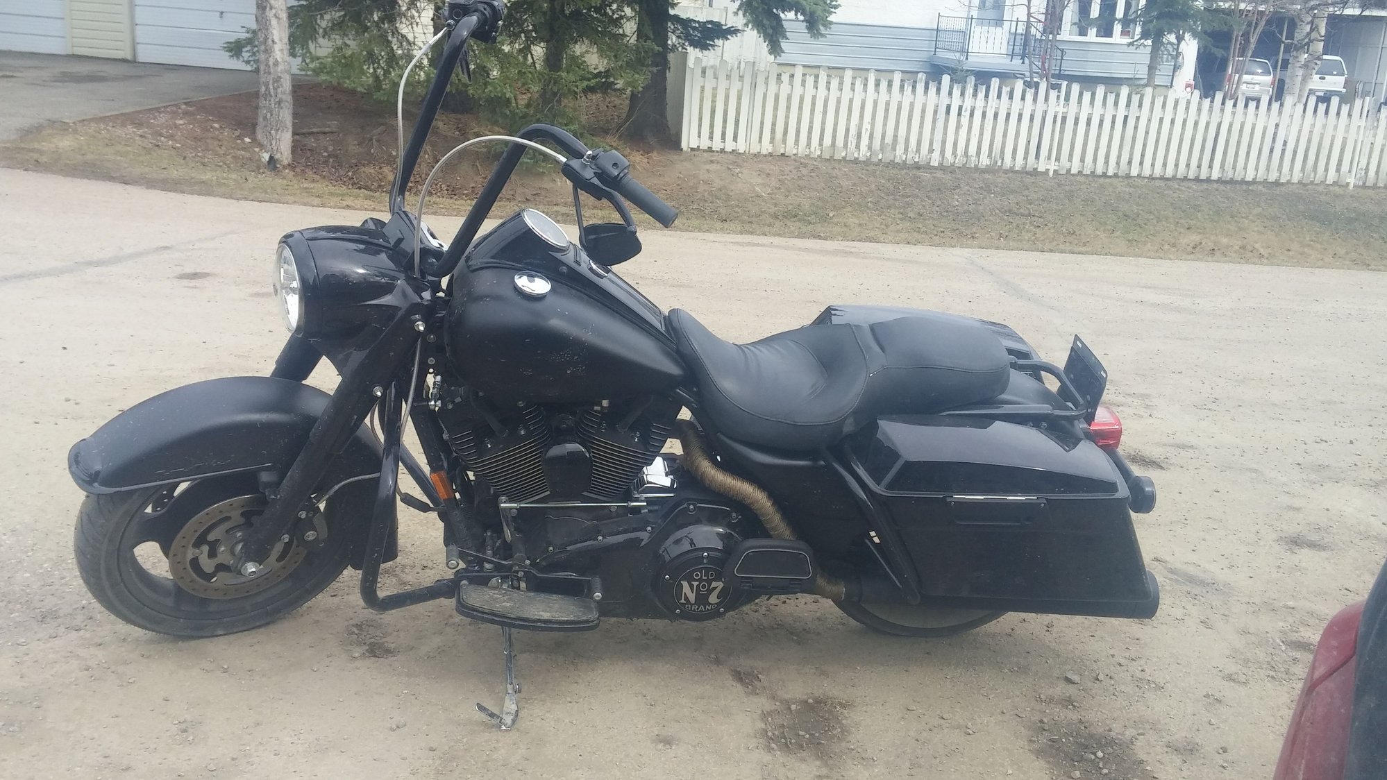

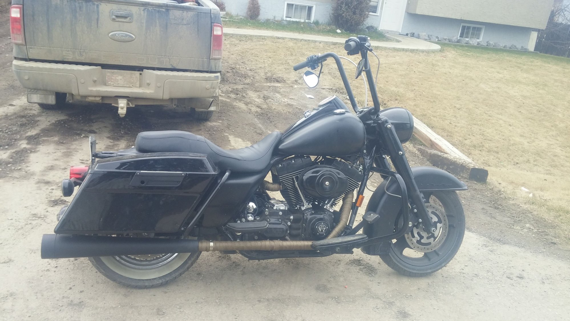

All good, got everything put back together.
I didn't use locktite going into the head, didn't make much sense to me. I did use antiseize on the other side, though. Dealer tech told me they thread the studs all the way in, that was good enough for me. Left me with plenty of thread.
Thanks again for the assistance.
-T
Next up: rear wheel
