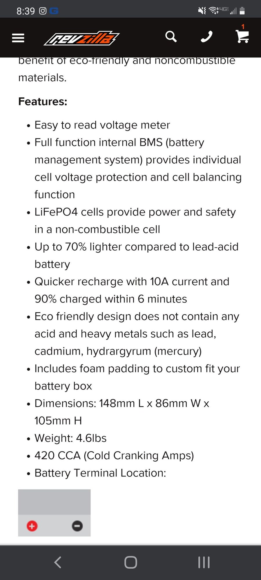

Well specs state 420 CCA on the newer BikeMaster Lithium Ion 2.0 Battery BMP21L-FP

Your post is exactly my point. Please understand I am just explaining the mis-information out there and trying to help others. You point out Revzilla, thing is Revzilla (and many other sites are just plain wrong, heck these bimbos dont even know the difference between CA (which is a bullshit rating) and CCA (which is a real industry wide rating) completely incompetent.
All one has to do is go to the battery makers site instead of relying on incompetent or downright misleading motorcycle sites like Revzilla.
Here is a photo of the battery, right on the battery there is NO mention of CCA, only a pathetic 360 meaningless CA rating. Which would put this weak little battery close to 300 CCA with less then half the reserve capacity of a lead acid battery, Not even close to be a robust battery for a large cruiser loaded with accessories.
