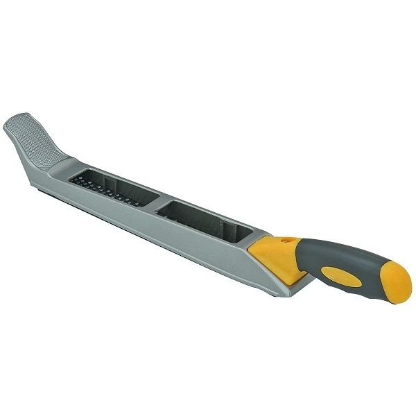

Well.... once they do cup it's pretty easy to un-cup them.
This works wonders and only takes a few minutes.
Jack the bike up, start the bike, and put it in 1st gear. Put the rasp on the ground facing up and lift it up to the tire.
Works awesome and has the tire running smooth as silk again in minutes.

Don't remember my Dunlops cupping quite as bad as the Metz, and I don't know that I'd use a rasp on the rotating tire either to even the tread out, but its an interesting concept.
