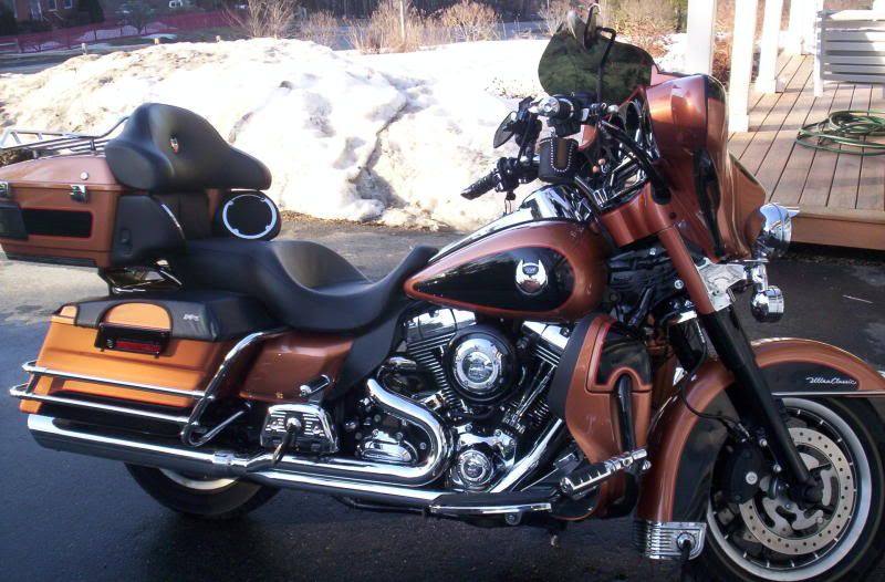

I had an 08 anny ultra. I changed the gearing with a EVO Industries 49 tooth ring gear conversion, dropped in a Zippers Redshift 575 cam and ran a D&D Fatcat 2-1 pipe and stage 1 AC. All bolt on mods. Had enough power to haul the wife and I around.
