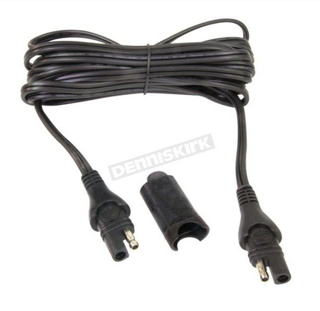

I've got a set of mini-jumper cables for use on a bike that won't start, but usually would require direct access to the batteries to attach the clamps. Today on a ride we had a bike that needed a jump and a rider had I believe one of these Charge Cable Extender . It worked like a charm connecting it to both bikes battery tender connections. Is there any reason why this would not be a great way to jump a bike?

Yes, and no, and I made a plug that I can connect my jumper to the battery tender plug directly.
Note, I carry a small jumper box, since If I going to have a dead battery, chances it will be when I'm all alone to start with.
The no part, is if your tender plug has a 4 amp fuse in line it it, it will blow the fuse pretty much from the start when you connect the jumper pack to it/use the extender to connect it to another bikes tender plug. The other one is the battery tender/tender extender wiring is only rated for about 4 amps to begin with, and the jumper box is going to put out way more amperage isntead.
So solution on your tender cable plug on the bike to the battery, is to upgrade it to one that has larger wiring, and that does not have a fuse that will end up blowing. Also, since the wiring is not going to be a large as what is really needed for a dead battery jump amperage transfer, you put the jumper pack on the bike for a few mins, in order for it to charge up the battery a bit to begin with.
The tender cable 4 amp fuse aside.....
Cable size is determined by the amperage the cable will need to carry....... If the wire is too small for the current, you will get increased resistance, voltage drop, heat, and possible melted cable.... the severity will be based on the how undersized the cable is, and the length of time the current is flowing through the undersized wire...
The battery tender cable size was selected to carry 1.5 to 4 amps.....
A big twin starter draws approximately 110 amps while starting....
I would never try to use a tender cable size wire for jump starting a Harley....
they would need this adapter to correct the polarity.
Without the adapter, polarity is reversed between the two bikes.
again, the tender leads on bikes are fused at around 4 amps, what do you think you are going to do with 4 Amps if you connect the bikes together.
The second you power the bike up you are going to draw 4 amps.
Change out the fuses to 10 amps, again you will be there all day trying to charge a weak battery, assuming that the batteries when trying to equalize out does not blow those fuses.
There is no way you are going to pull starter level current thru that wire without it melting from to high a resistance due to lack of surface area
