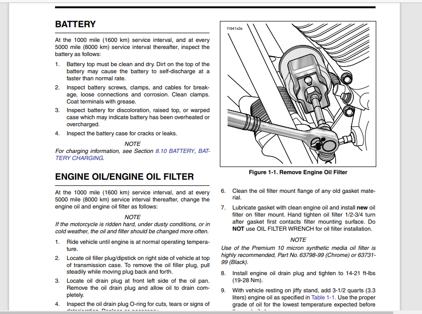

The HD Service manual , 1/2 to 3/4 turn after gasket touches. KN says 3/4 to 1 turn. I use KN and go 1/2 a turn and never had any problems getting them off.
HD says hand tighten

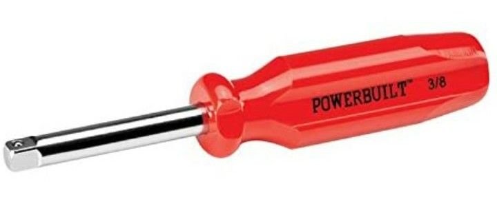

Originally Posted by Crabchuck
What kind of girly little hands do you have to actually get in there and get a grip on it so you can hand tighten?
I use these to hand tighten.
With a clean hand, the most I can muster is 45 in-lbs of torque. Never had a leaker, and never had an issue with removal.
