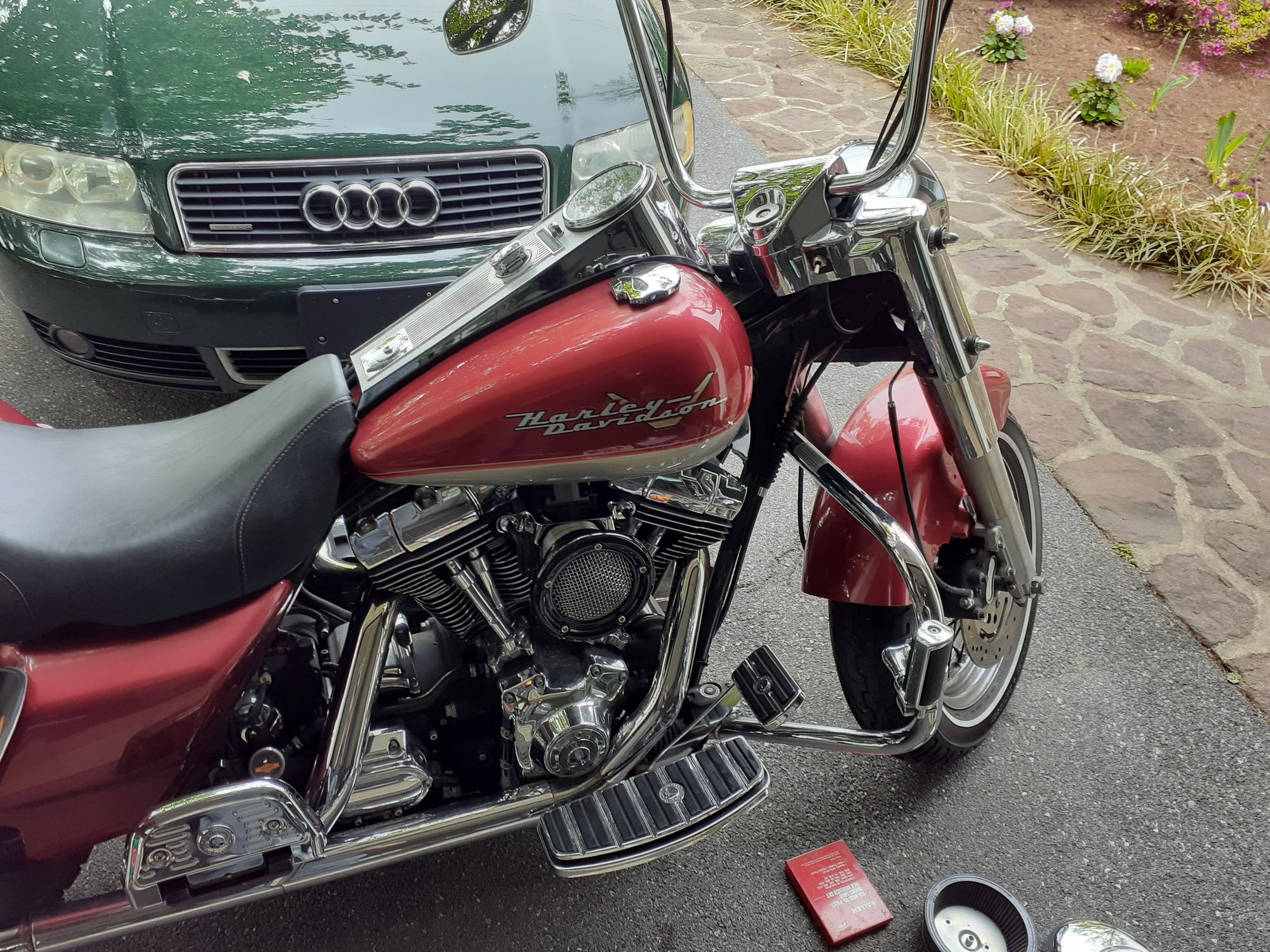

I've upgraded my air cleaner and intake to the Kuryakn Velociraptor velocity stack, still only had stock header with SE slip ons. I'm wondering if there is a certain type of exhaust I can add to compliment the intake? Planning on upgrading the ignition system right when I do the exhaust and putting fuel management system on as well. So basically I just kind of like everything to work in conjunction with one another while I reap the benefits! Any input will be greatly appreciated!
16\" ape's, badlander seat, HID headlight, LED turn signal integrated tail light, small stuff here and there. Lowered 1½" in the rear and progressive springs in the front to lower it 1". Plenty to do yet!

I would consult with whoever is the maker of the "fuel management system" you are planning on using. See what Stage I tunes they have combinations for, and any recommendations...
