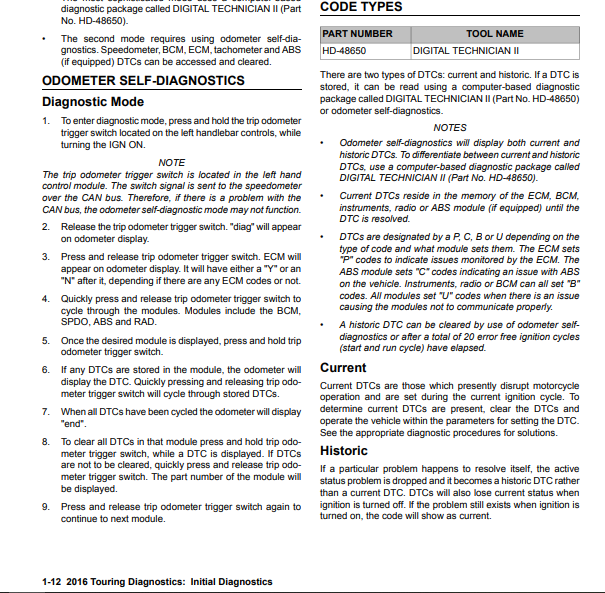

Make sure the battery is fully charged and good. Pull it, charge it, and have it load tested. Or pull the small solenoid wire from the starter and, with bike in neutral, jump it from the battery positive, (wire with rubber boot), on the starter. If it won't crank over the battery is weak.
I know you said there is nothing in the odometer, but did you try to retrieve codes? Hold trip button down then turn ignition on?

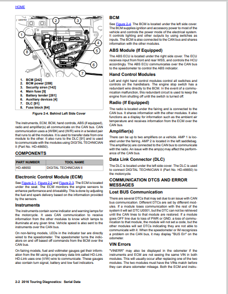

The right and left hand controls are now modules and communicate with the BCM via CANBUS. Does the Left turn signal work?
You can join this Facebook site and find the Service and Electrical Diagnostic Manuals for your bike. Click on files then type in 2016 to search.

Unplug the wires going to each hand control and turn the ignition on, see if the odometer will display.
Did you try holding in the odometer trigger switch then turning on Ignition? When you do this the DTC's should show in the odometer window.

Originally Posted by Vernal
@JKimbrough
I tried this and still no change
