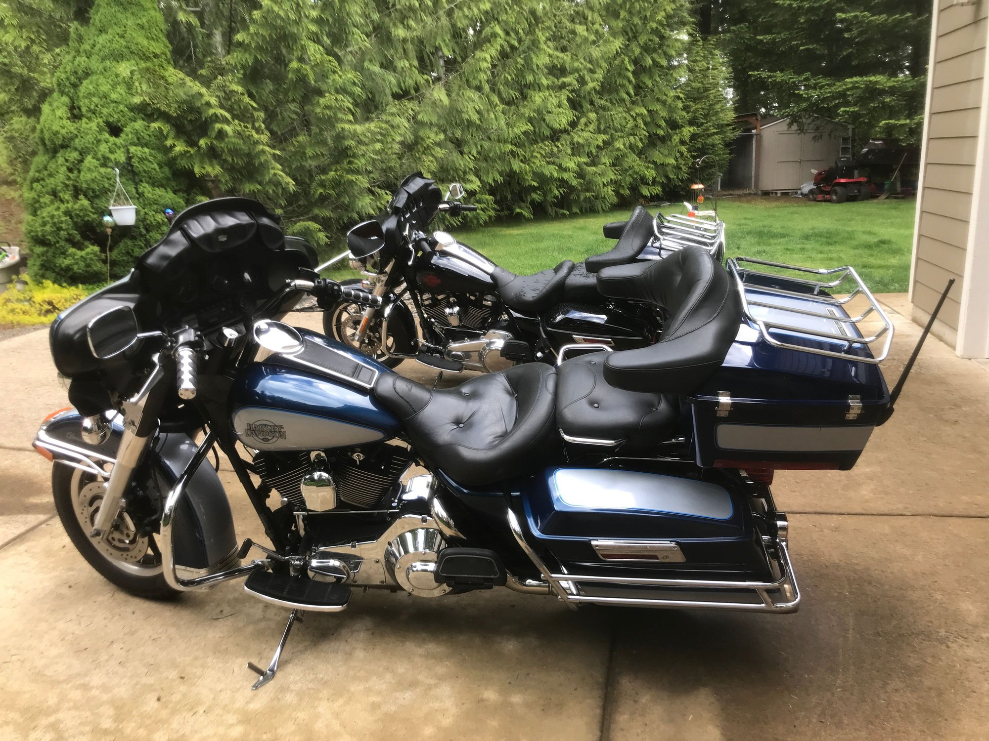

I sold my 2000 Electra with 200,000 miles on it for $6000 but pretty much everything had been gone through recently,I had that much in the 103" stroker alone so that's about all I got was my money back spent on the motor.
That was almost 4 years ago and the guy is still riding it,he even called me last year after a trip to Sturgis from Oregon and back.
I'd still be riding it if I hadn't test ridden an M8 Electra and fallen in love with it.
I bought the 2019 in Sept. '19 and sold the 2000 in June '20.
This pic reminded me that it took me a couple years to break the fuel petcock, compression releases and choke habit.

Ha ha,I hear that,I was reaching for the fuel and choke for a while too but that bike had S&S 570G Easy Start cams so no compression release.
