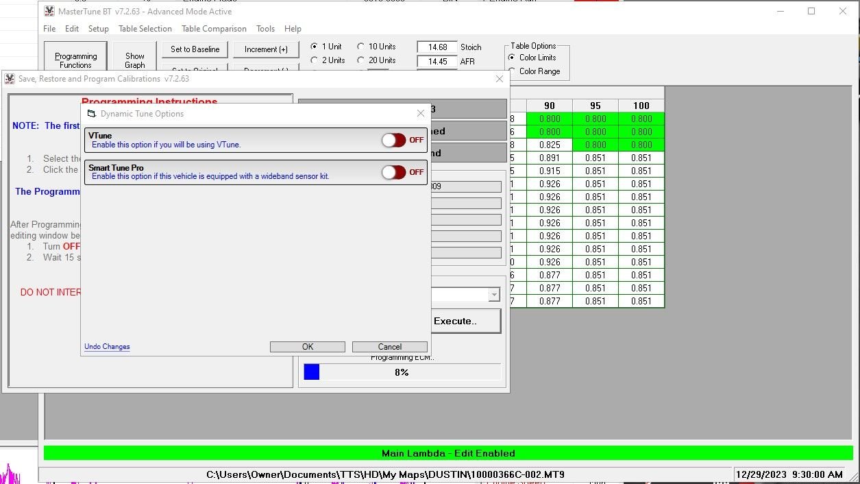

Another option for using broadbands for tuning is using SE Smartune Pro with the TTS. You don't need a special calibration as the "switch" is only flipped when you program the map. Clicking either tab will set all the parameters for you.
Then when you are collecting vtune data just select the proper o2 sensor.
This will give you the wider range of the broadbands to get all the areas you can reach. Then I believe you can remove the Smart Tune Pro as it's not married to the bike, and then use the stock narrow bands which are much faster and accurate to finish the tune. Just another of many reasons the TTS is the top tuner imho.
