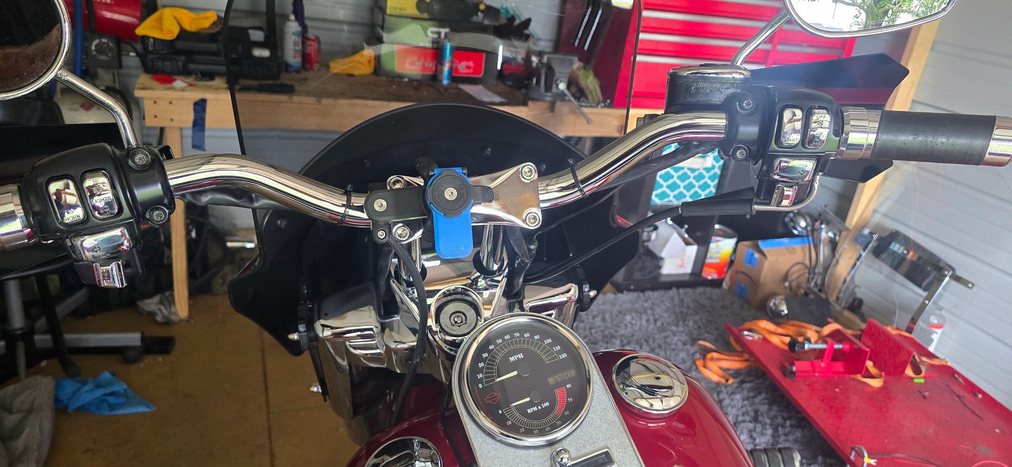

After months of searching ebay and facebook groups searching for the needed oem cruise control parts i finally 2 weeks ago found a 04 road king being parted out on ebay.. only saw the module for sale so i messaged the seller to see if he had the controls... well he did so i purchased it all from him... only bummer was it wasnt plug and play on the hand controls... 04 has the deutsch connector and my 07 rk has a different kind... so a litlle cutting and soldering and bam... its on and working awesome.... thank you to anyone that helped with wiring diagrams as this was my first time doing anything like this.. i love this forum

Nice!! After a couple years on my 05 RK I initially thought I wanted cruise, I installed the CruiseMate flipper switch on the throttle tensioner and a few trips its serves my purpose as I get bored having it activated too long. I could see on long hauls over 4 lane Highways across the Midwest plains states cruise will be nice though!!
