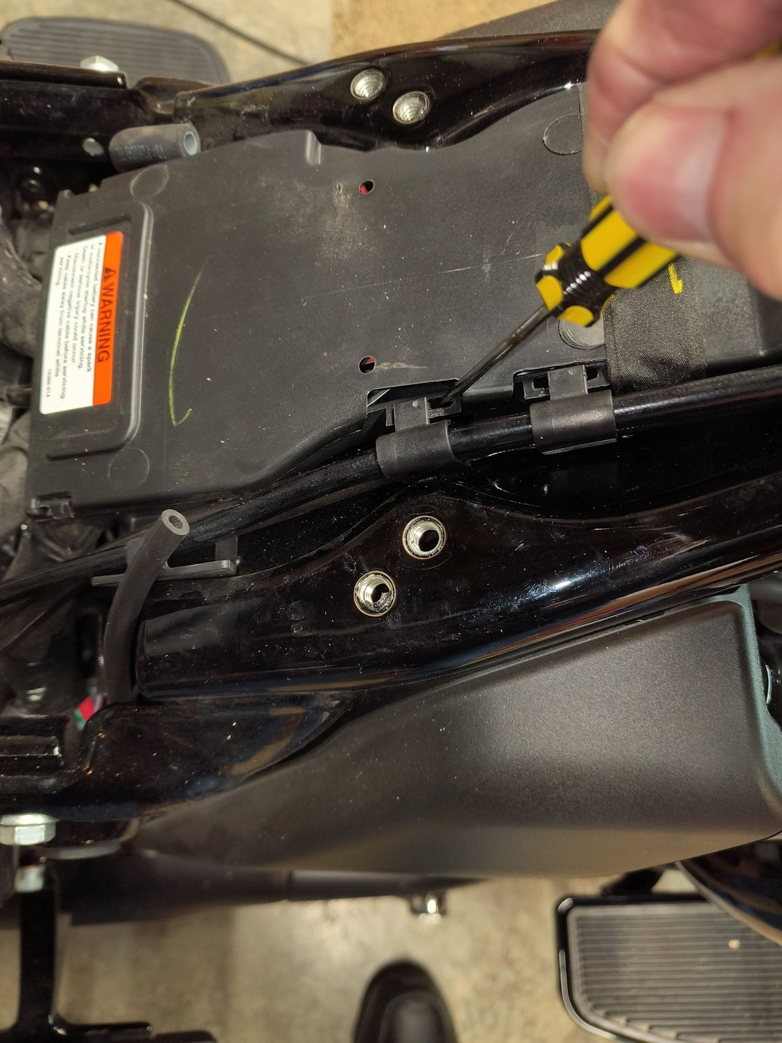

Can someone tell how to remove these brake line clips or keepers, I don't want to break them?

Got it done

They are just a plastic snap but they are tough. I put a pick under one side and pried up and it popped out.
