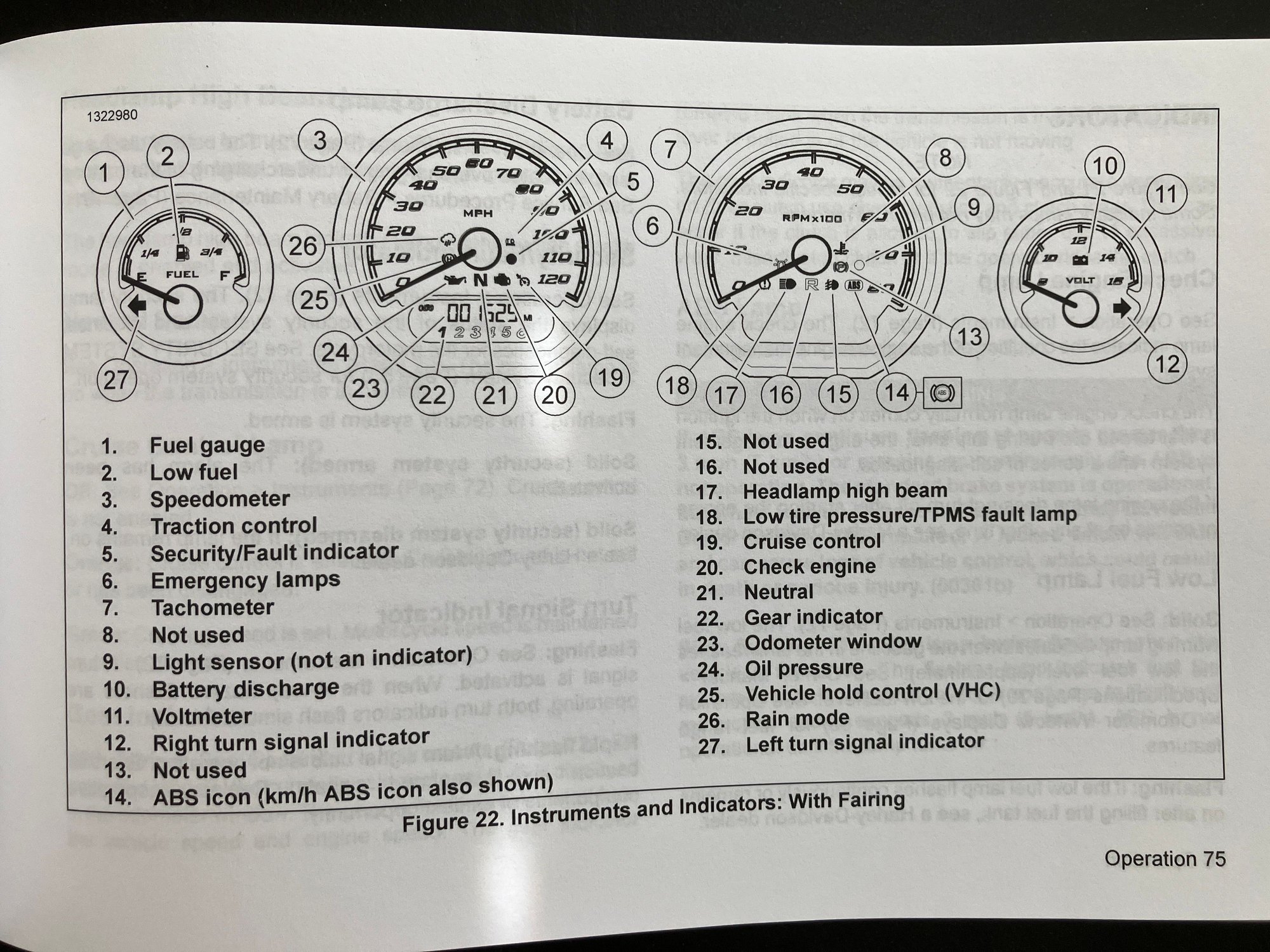

Edit: I forgot I meant to ask about the passing light switch. Is there an indicator or the speedo letting you know the passing lights are on? Since they were taken off of his bike if there is an indicator it might help him troubleshoot.

On the most recent FLHTPs, it will be indicator light number 6 on the tach, just above the high beam indicator. It is multi colored green and yellow depending upon what mode the emergency lights are in. Confusing, I know, but when it is off, that circuit should be off.
His will not have number 26, rain mode, as that came out with RDRS in 2020
