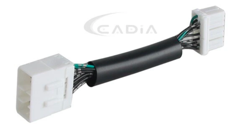

Bought that wire connector inbetween thing that keeps your spotlight on when you hit your high beam for $20.
Then after finding the connector it goes between I could see I was going to have a real hard time getting my fingers in there and seperating it without the risk of messing up something or breaking the brittle tabs on my 2008 Electra Glide.

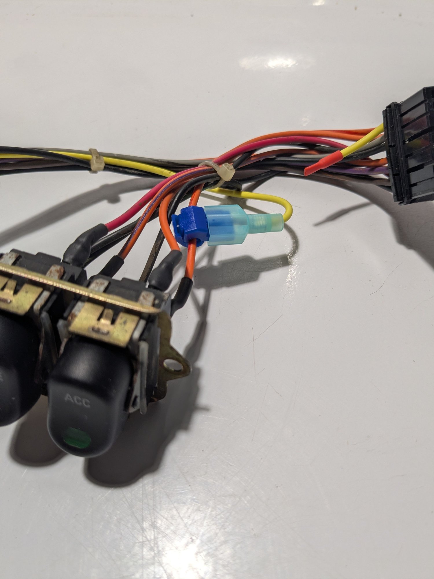

So I found this information - all the credit goes to Ron Webster.
I was replacing my panel switches anyway as my speaker one was damaged so did it on a table - but you could easily do it on the bike like he did. I had to watch it multiple times as he does it fast and you only see the wire he's taping into for a split second.
It's the orange one with red stripe on the AUX switch (the lower wire).
Cutting the yellow and putting it into there.
And, no, you don't have to have the aux switch always on.
I sealed the cut yellow with a piece of shrink wrap.
Works great, cost about a dollar.
Thank you Ron Webster.
Highly recommend.

I ended up putting that in between wire harness on anyway.
It gives you a little more room when you take that lower panel off to move it aside when you change your fork oil.
But the high beam and spots was working before I installed that with just the clipped yellow wire teed into that orange wire with the red stripe.
