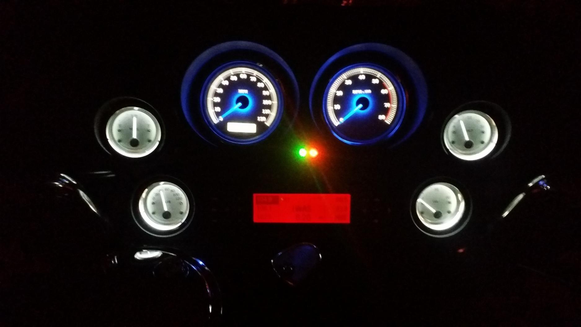

http://cimg9.ibsrv.net/gimg/www.hdfo...9d72314380.jpg
marty did mine

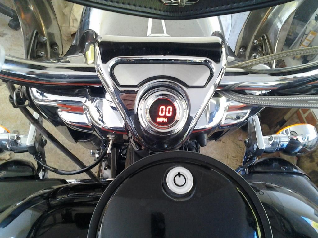

Not exactly where this thread was going but I'm kind of proud of it!

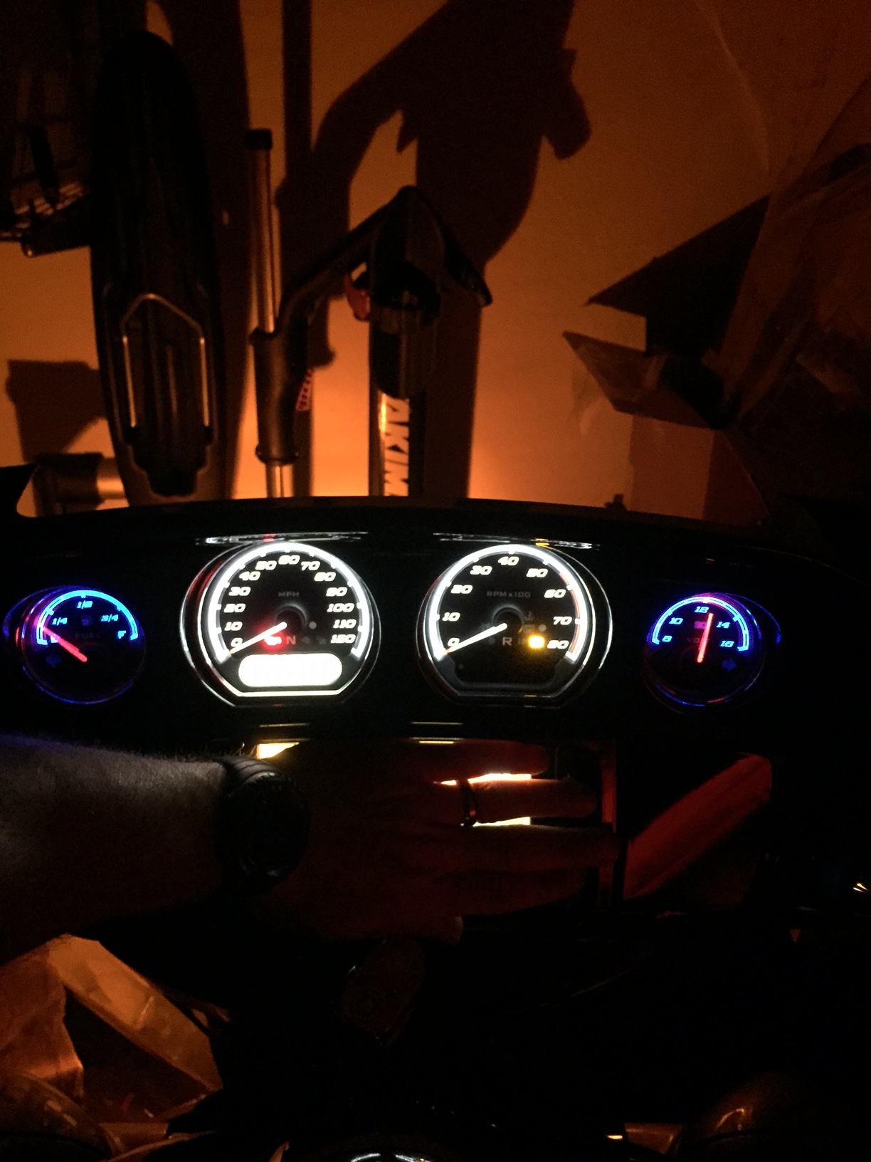

Originally Posted by Mrmayhem
halfway done
blue background and red needles
changed the odometer lcd to blue as well... the white reading (as seen in the first pic was too bright).
This looks freaking awesome! I want mine done like this. How can I make that happen?

Not that hard to do... just not for the faint of heart. I can tell you how it's done.
But the basics are: just remove your gauges... you need to get the lenses off the gauges.
De-solder the old chip lights.. solder in the new ones. Reassemble.
NUMBER ONE ---- BE CAREFUL.. you can EASILY break the glass with very little pressure. Make sure the needles are not moved AT ALL!

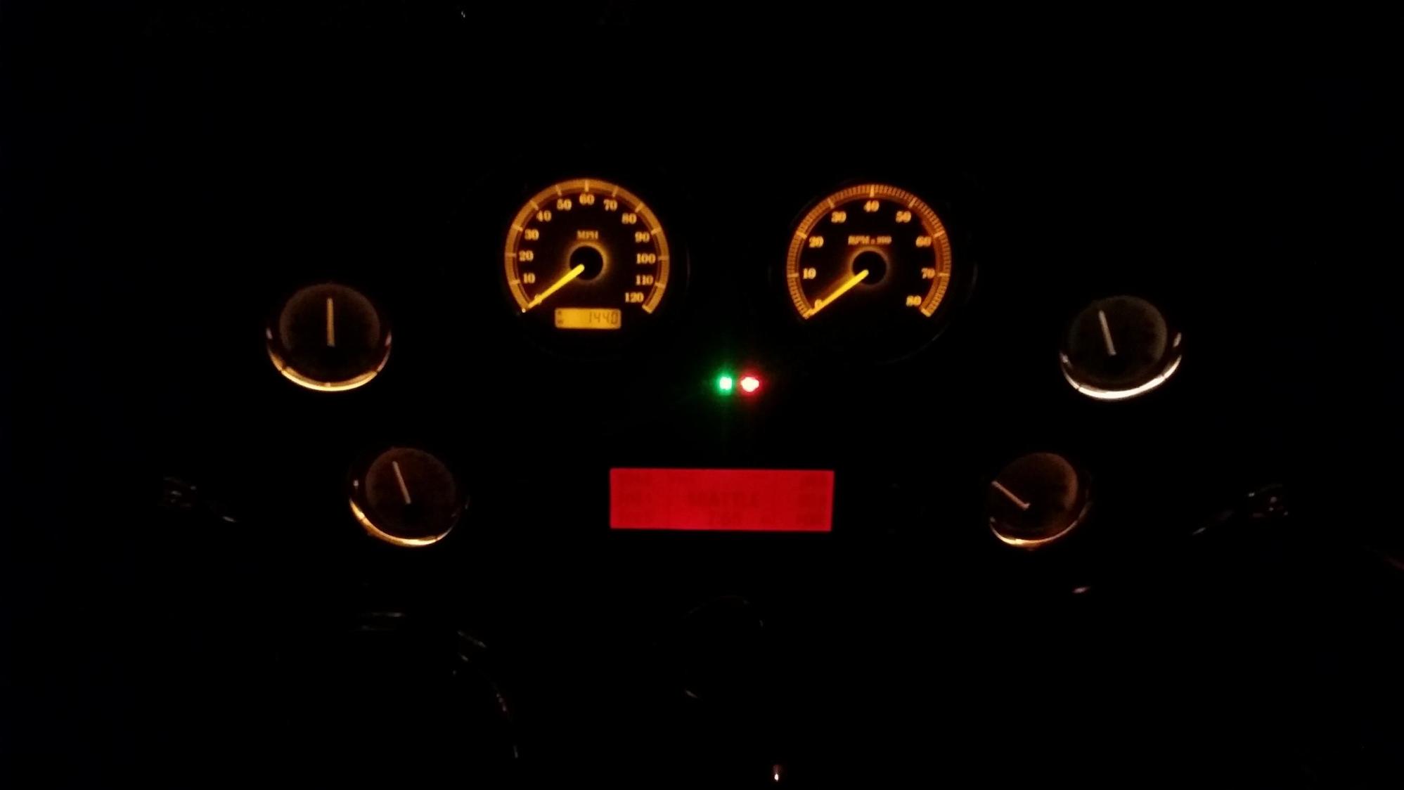

Before
After
