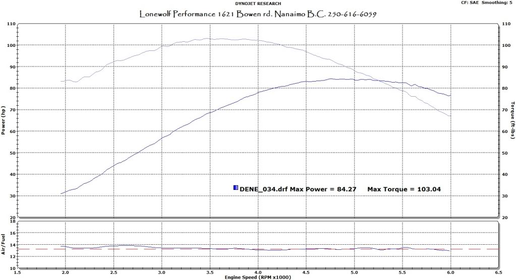

Default Happy with my 204 characteristics in a 103
I think you will like them. Mine pull where I want them to and I'm sure 95% of other bagger riders will like their power curve also. I find they do fall off and don't pull anywhere close to redline, (I do not run a tach). I can't imagine needing any more power so I bought these with the intent of never doing future headwork etc, as like you. Good luck.
