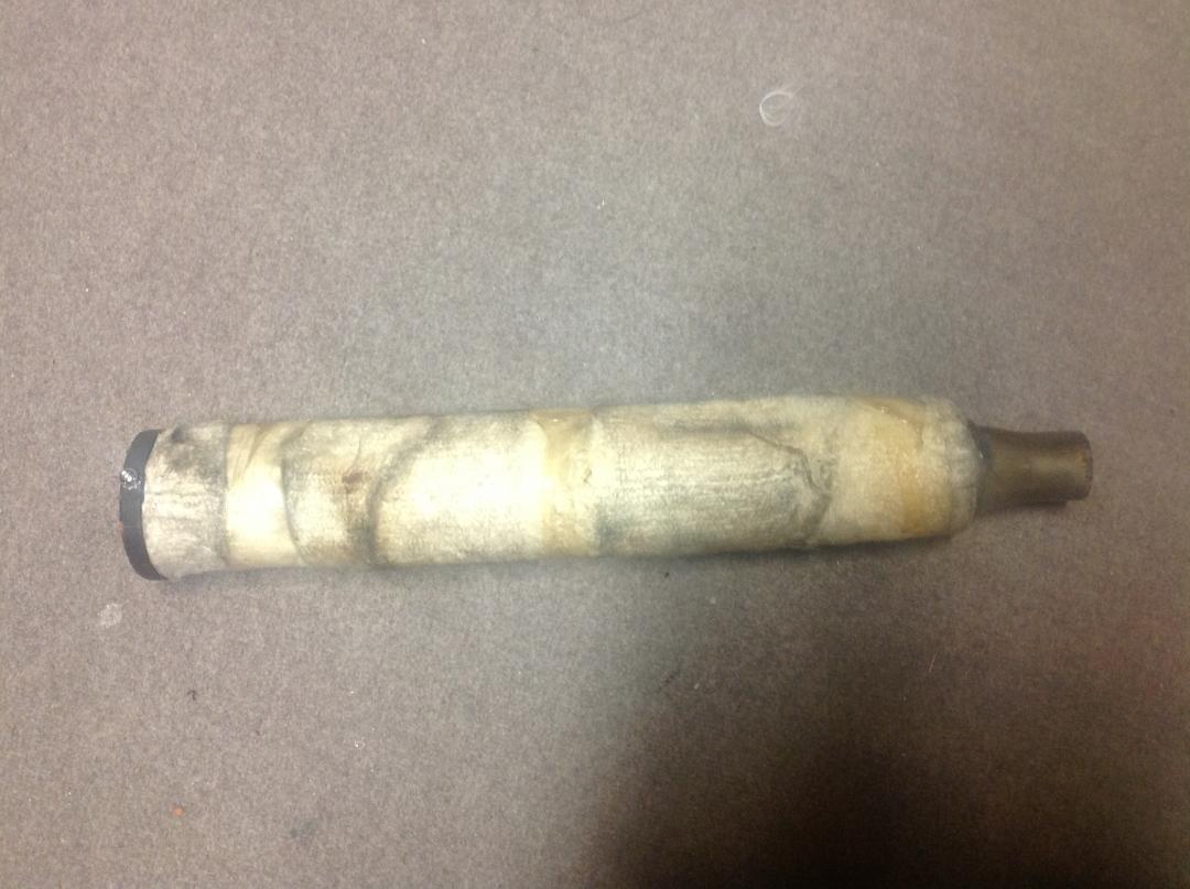

You can remove the baffles and wrap them with FMF fiber glass matt. I did and it "mellowed" them out nicely To remove them take off the tips and remove the Allen screw that holds the baffle. With a flat piece of wood on the floor and holding the muffler on the inlet side give it a few hits on the wood(the wood will protect the chrome) and the baffle will loosen...then take along screw driver and tap the baffle out the rest of the way from the inlet side. Wrap the baffle using some plastic shipping tape, then line 'er up and tap it back in making sure the holes line up and your good to go...here's some pics w/o and with the FMF matt
Attached Thumbnails Rc components slip ons-photo-1.jpg   Rc components slip ons-photo-2.jpg
