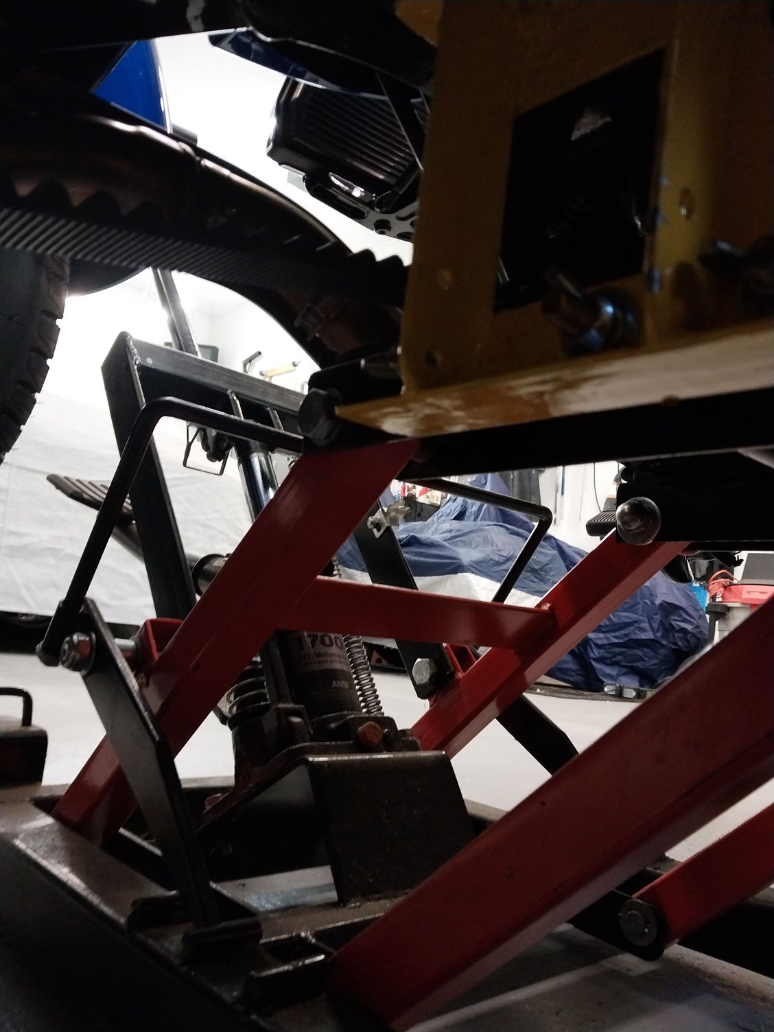

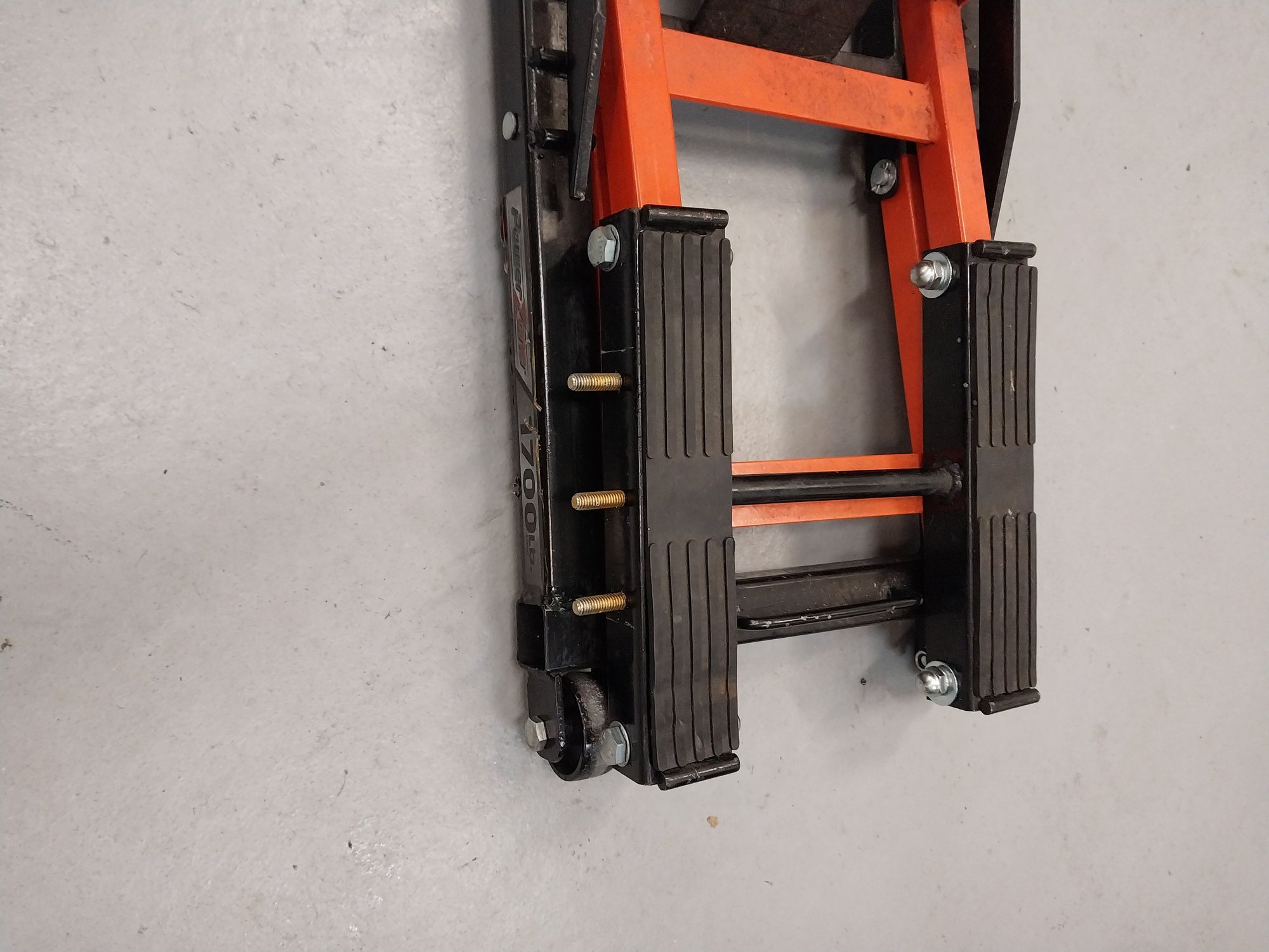

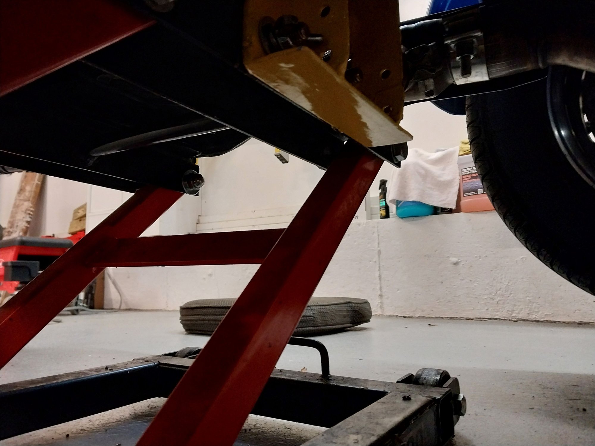

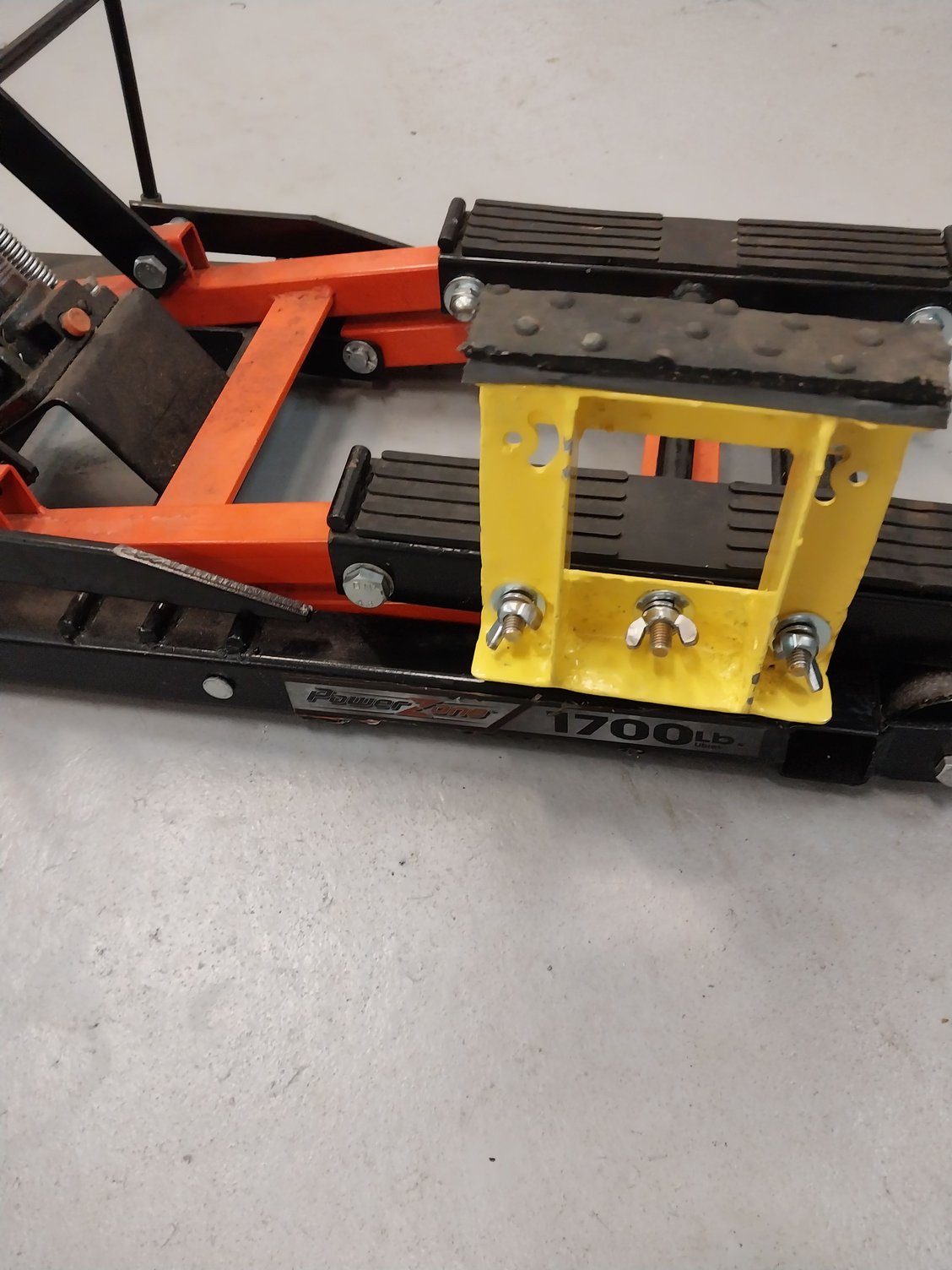

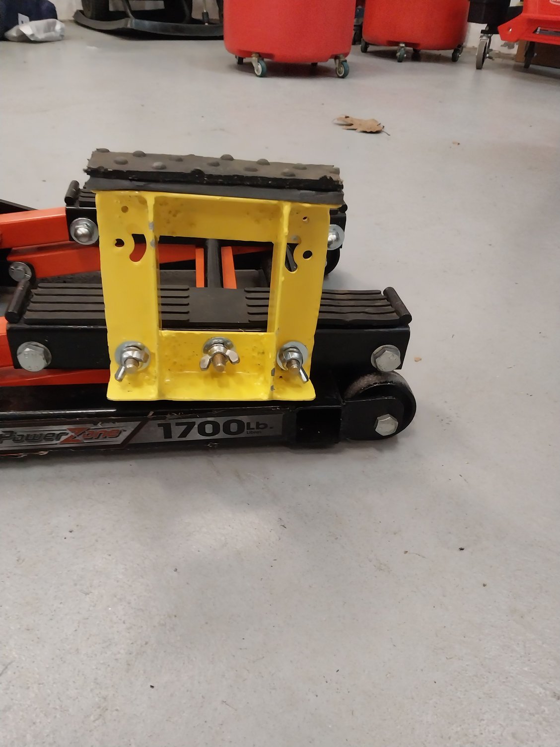

Using a piece of 1 1/2 inch angle iron and 3 grade 8 bolts you can with a little time and a welder create an adapter allowing you to jack up a Harley Tri Glide with a motorcycle jack.
Photos attached.

The adapter is 6 inches wides and 6 1/2 inches tall plus 3/8 inches of rubber padding. Therefore the overall height is 6 7/8 inches tall.

Not true. The rear frame of the Harley Davidson Tri Glide is approxiamtely 7 inches recessed from the front The adapter is overall 6 7/8 inches high.
In the front section directly below the engine when the jack hits the frame. In the rear recessed section there is about 1/2 inch prior to the adapter hitting.
Therefore when lifting / jacking up the trike it is almost level with a very slight pitch to the rear.
I intentionally made as the slight angle to rear adds to stability.
The weight of the trike is disributed fairly evenly on the jack.
The jack that I use is rated for 1700 lbs and I personally never try to exceed more than 80% of a rating or in this case 1360 lbs.
