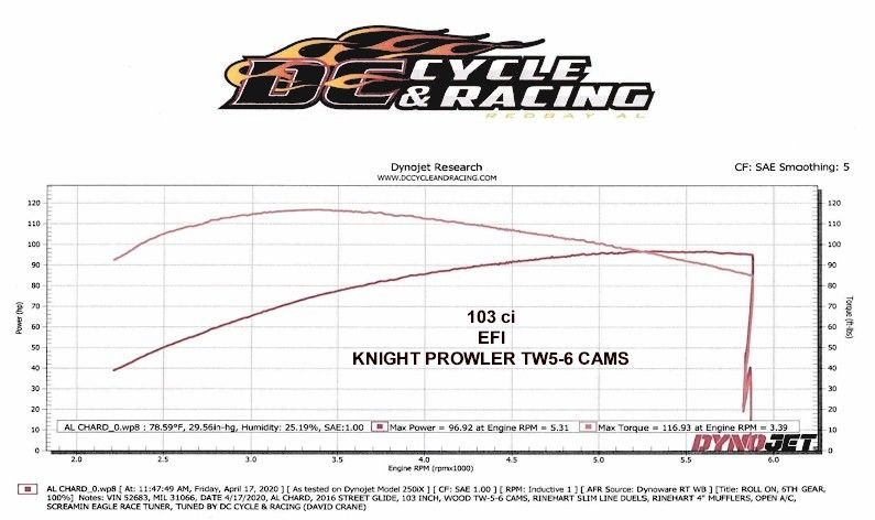

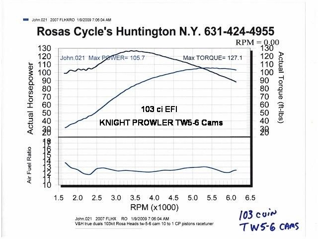

The Woods TW 5-6 it's an overlooked Cam that has great low end and can still out climb the 222..TDC LIFT is a little higher improving cylinder fill...
I haven't found any dyno sheets on those cams, in a 103" TC. Do you have access to one?

I will have mine done In a couple weeks..
The following the charts were downloads from Knight Prowler (Bob Woods) website..2 with motor work one stock..
A lot depends on the exhaust you will use..
