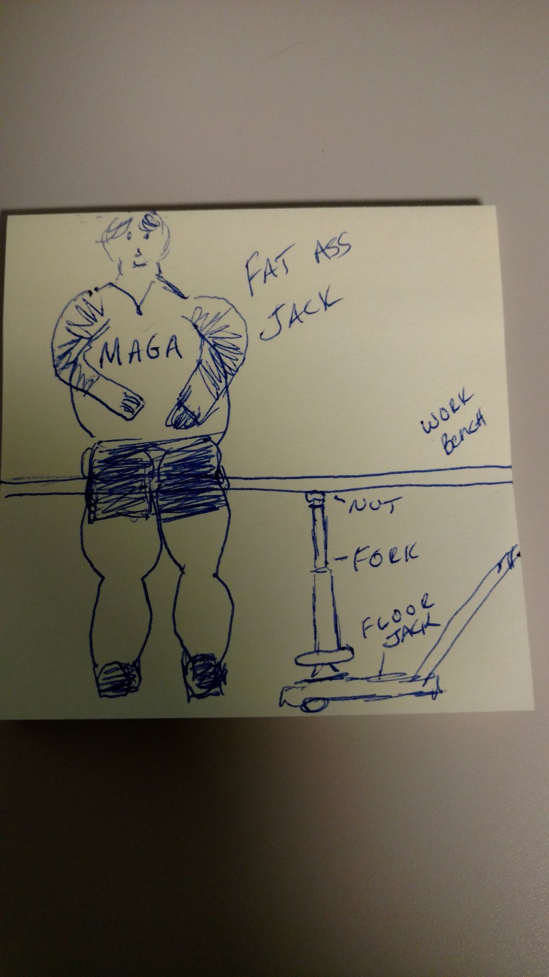

The next issue coming up, will be compressing the springs to get that plug started again. LOL... I made up this picture to help someone in a pinch.
So you basically take the floor jack and put it under your bench and add the fork, and jack it up slowly until you get close to the plug, putting just enough pressure to compress the spring and using vice grips or channel locks to rotate the plug clock wise until you get it started.
