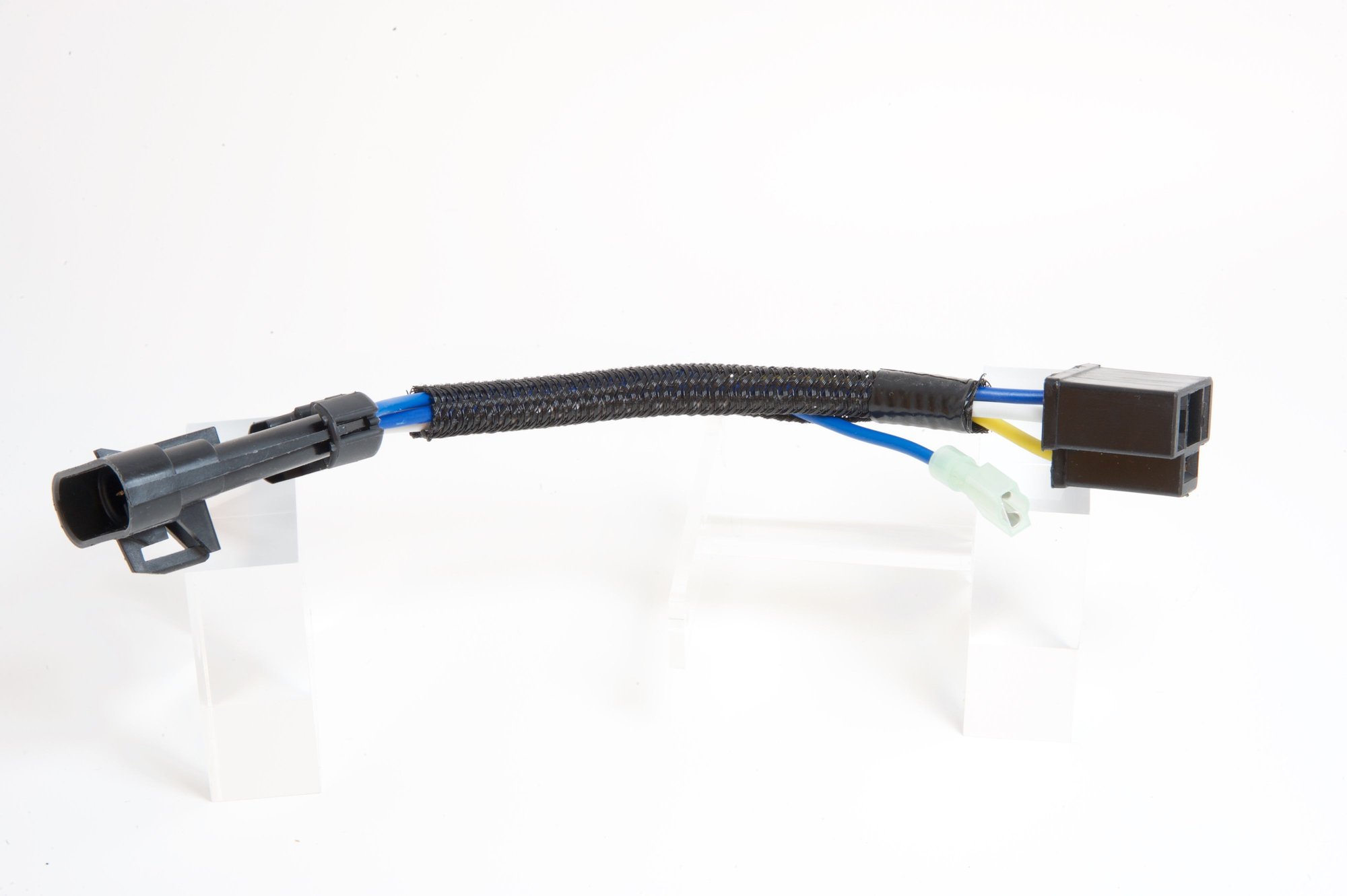

You will remove the dual halogen harness and install an H4 conversion harness in its place. Like so.

From: Pennsylvania
Is that conversion cable an HD part?
Thanks!
Old Dec 3, 2015 | 02:37 PM
p51bombay's Avatar
p51bombay
Joined: Jun 2010
Posts: 5,105
Likes: 16
From: Blaine, WA
That one is Custom Dynamics, also available from Kuryakyn or Harley - all pretty much the same other than the KY one has a 90° plug.
