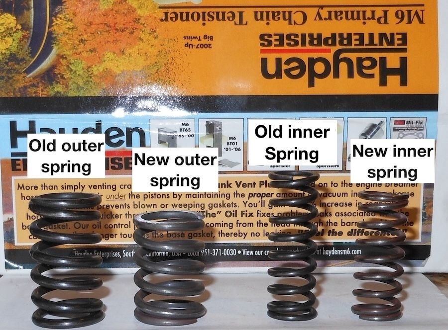

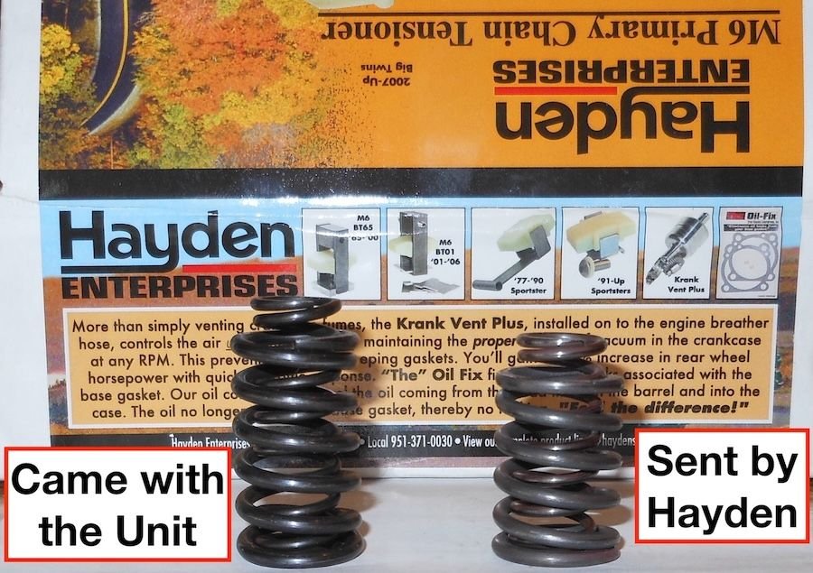

Hayden has always had a good reputation, but made a mistake when they came out with the M6 BT-07 Tensioner for the '07 - '17 Touring models.
Either something changed around 2010ish models, or Hayden didn't do their homework before they came out with the '07+ tensioner model. The springs didn't work in the '10ish and up models.
There were a lot of people trying to install it, but with just the supplied springs and no shims, it was far tighter than Hayden's install instructions called for.
Many were complaining about the inability to adjust the Hayden tensioner to the supplied specs, and how tight it made their primary chain... which was the very issue they were trying to avoid.
This issue soured the Hayden tensioner in the minds of many people.
FWIW..
I bought one for my 2012 Limited. Before I installed it, I started reading the numerous complaints about the issue on this forum.
Hayden listened, and stepped up. They changed the M6 BT-07 to shorter springs, and even sent me a set of shorter springs, to replace the long ones my tensioner came with.
I'll give Kudos to Hayden for their customer service over the issue.
However, during the wait for the new springs, I learned about the history of the HD adjustable primary chain tensioners. I learned the "B" version in my 2012 Limited was a pretty good design with far less issues than the earlier versions.
At that point I decided to leave the OEM "B" tensioner in place. I never had any issues with the "B" tensioner in my 2012 Limited, or the 2016 Ultra Classic I traded in the '12 for. The '16 has had a 124" crate engine (135HP/151TQ) in it for the last 25K miles of it's 51K total miles. The OEM "B" tensioner has not had any issues in that application either.
I have the Hayden on a shelf with both sets of springs.
Here's a couple pics with both sets of springs. The longer of each spring came with the unit, and the shorter of each spring were sent to me by Hayden.

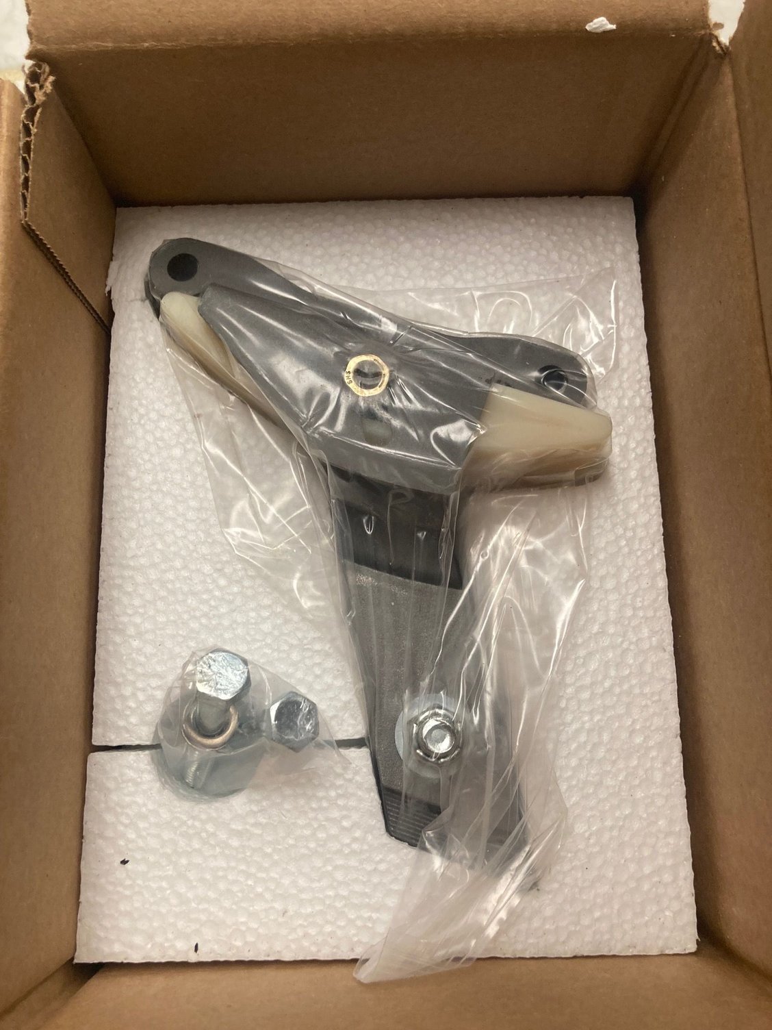

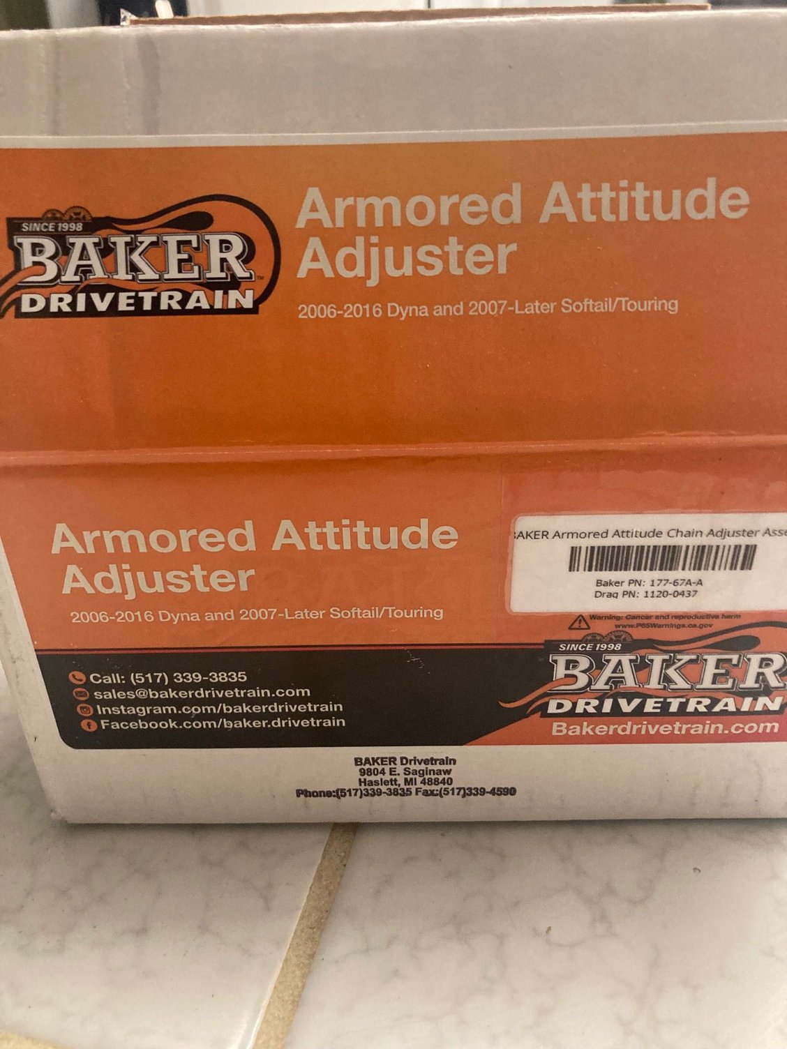

I have a brand new Baker attitude adjuster still in the box I would love to sell for cost. I had to install one on my 15 and assumed it was still a problem and purchased one for my 20. My 20 never showed the signs of failure
like my old bike so there it sits.
