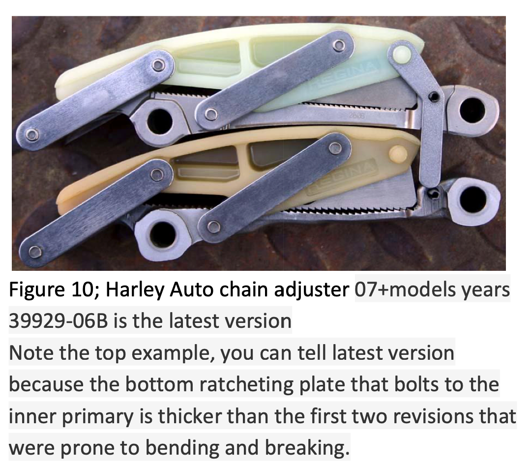

Personally, I would not move away from the factory tensioner. Yes, in the past there were issues. The current stock design works very well.
From GMR Performance: We strongly recommend using the current version stock Harley auto chain adjuster. This has proven to be reliable and provides the smoothest and quietest operation.

The 1/2 - 5/8 inch setting is the initial assembly setting of the OEM tensioner, not the position where the tensioner operates. As stated in the notes in the service manual: "Primary chain tensioner will not complete adjustment until vehicle is ridden."
The stock tensioner is not overly rigid and provides some compliance to the system. It does not make the chain too tight. The primary chain has well over 500 pounds of tension in it when engine torque is applied.
