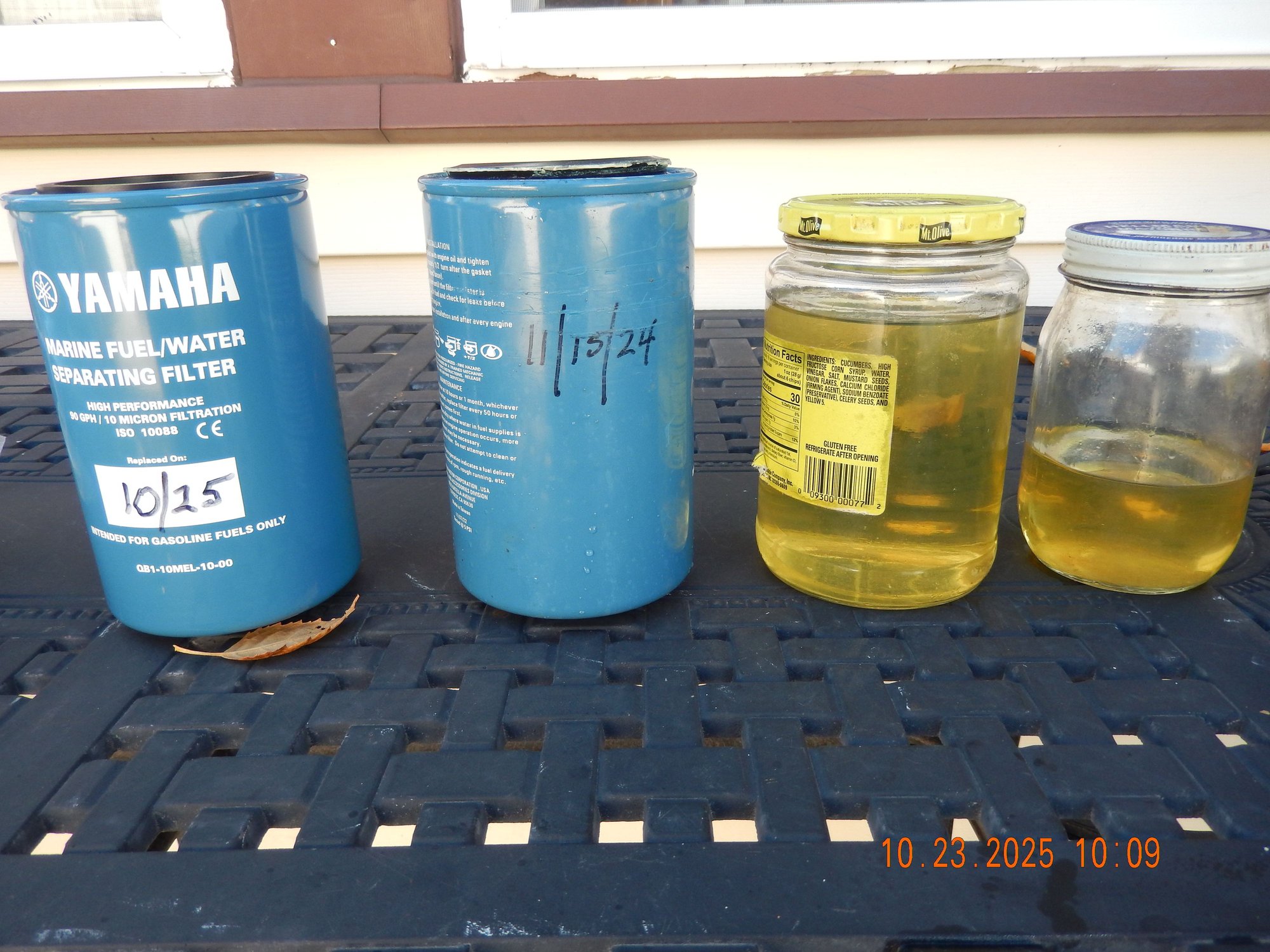

Originally Posted by Goose_NC
Many years ago, I put some non-ethanol gas into a quart glass jar. I also a quart of ethanol. gas. I out them both on a shelf. This was in Florida. With in a month, the ethanol was visibly starting to separate. The regular gas did not. After 90 days, there was three distinct levels of separation. The regular fuel had a small level of separation at the top.
That's my experience with ethanol fuels.
That's an interesting experiment and I'm gonna try that. I always have fresh gas laying around for the sno-blower, generator, etc. Every fall I service my Yamaha F150 outboard motor and part of the service is changing the fuel water separator filter and the motor fuel filter and in the 7 filter changes I've done over the years I've never seen water in either of the 2 filters. The gas I get on the water does have additives so that might help the water situation but the boat is either in the water or stored at the marina all year. That being said I unfortunately live in New Yorkistan and non-ethanol fuel is not available, if it was I'd be using it in most everything I own. Below is a sample of the gas I drained out of the separator filter in October. Thank you...
