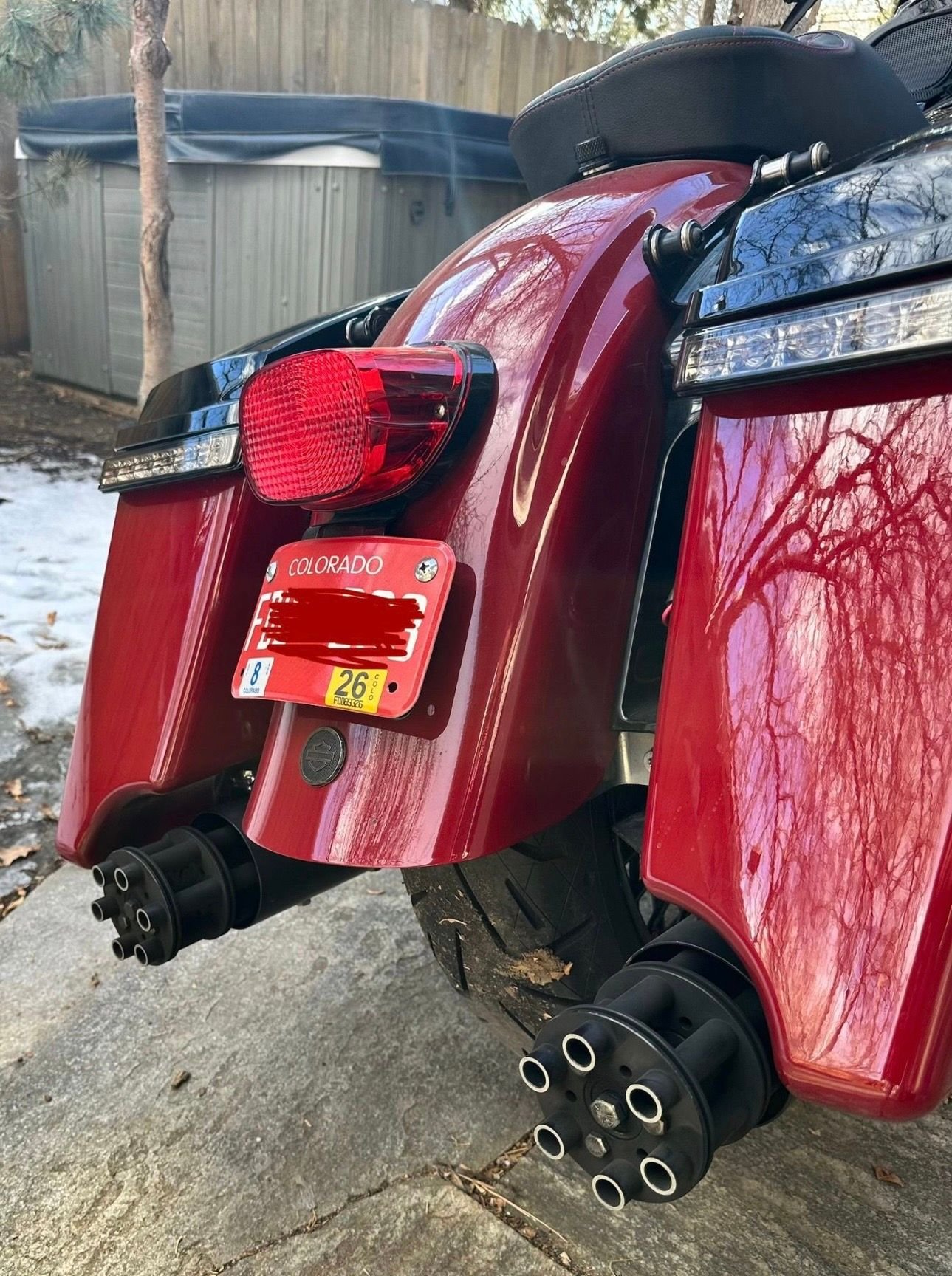

The PO installed additional LED light bars in the rear on the side cases. Maybe the red “dot” warning has something to do with those? The weird thing is the seemingly random occurrences.
