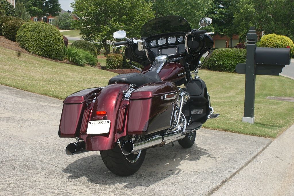

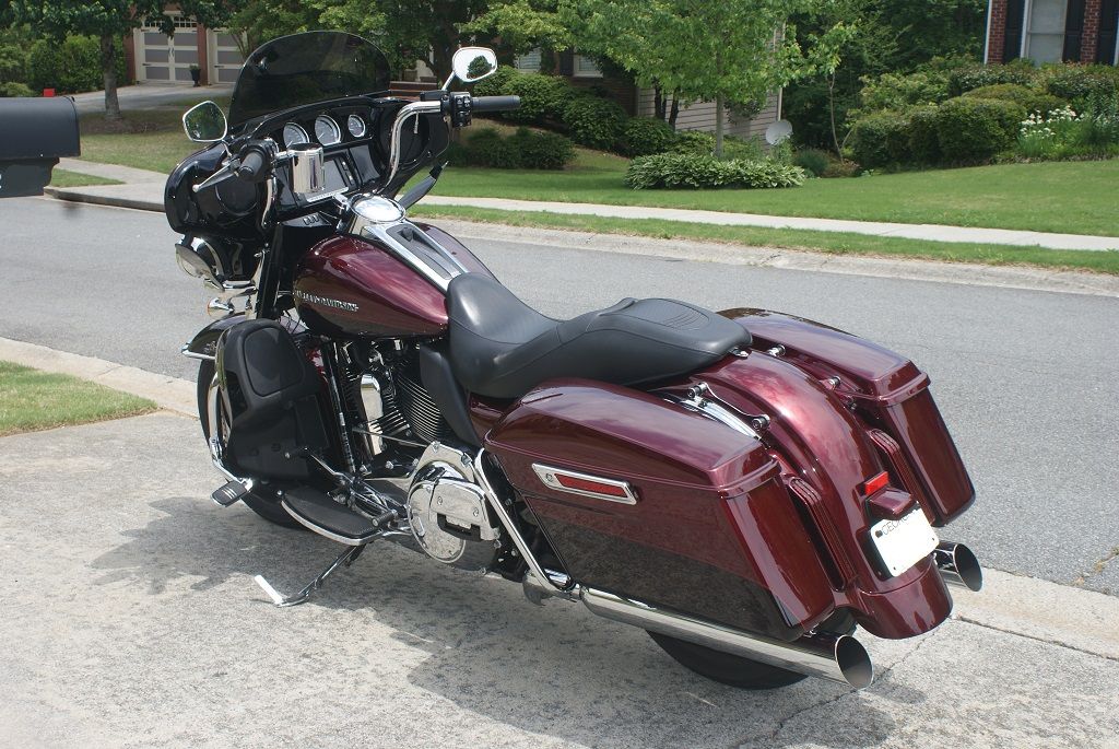

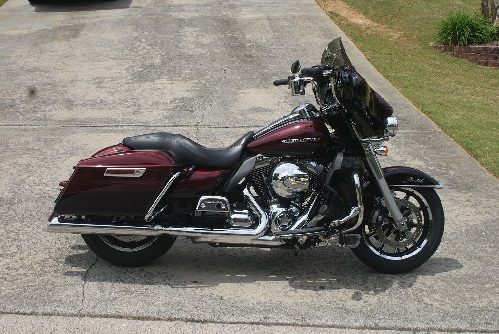

I installed these bars on my 2014. The clutch and brake lines were fine as well as the wiring harness for the heated grips and TBW. However, I had trouble with the wiring for the left and right controls. Running the wiring inside the bars just didn't leave enough to reach. You can pick up an extension kit at the dealer for $30. I did this and it worked like a charm.
The dealer tried to sell me the TBW replacement that eliminates the connector that is in the middle of the harness. I found that I was able to run the original TBW through the bars with no problem.
I did slightly loosen the banjo bolts on the clutch and brake lines and twist them down slightly to keep the line off my fairing. Be careful not to loosen too much or you'll get air in the lines. I love these bars.
Here are the pics after the install.
[IMG][/IMG][IMG][/IMG][IMG][/IMG]

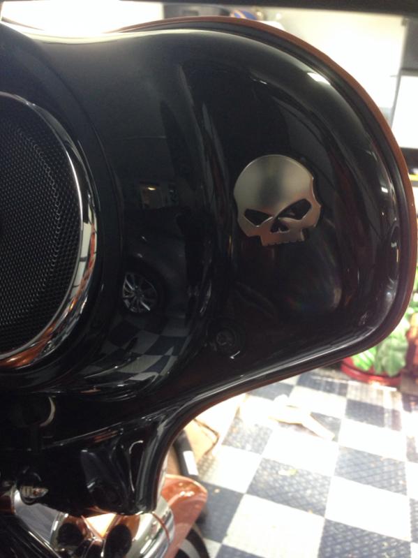

thank you for the information. I have one quick question concerning the installation when the stock mirrors are removed what do you use to fill the opening for the stock mirrors if any? I see the new mirrors and they look great.
Old May 23, 2014 | 01:04 PM
barrygreen's Avatar
barrygreen
Joined: Nov 2005
Posts: 3,654
Likes: 362
From: Mansfield Texas
On the 14s the space where the stock mirrors are pretty flat so you can do just about anything to cover the holes, some use caliper inserts, I used the Willie G Skull medallion, Harley has a few stick on goodies that are small enough.
Attached Thumbnails Wild 1 578 10" Bars, anyone mount them?-image-2756967308.jpg
