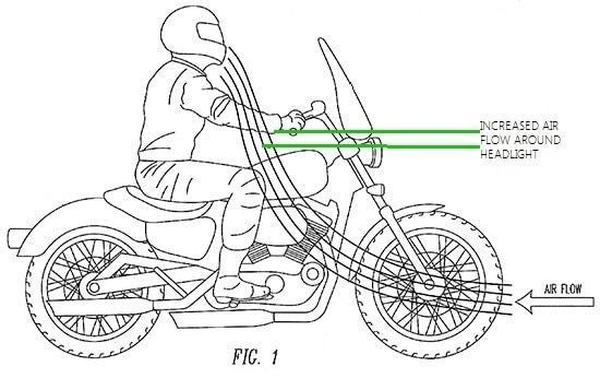

They offer another option at Clearview:
Clearview Shields normally creates their Cruiser replacements to match the appearance of the rider’s stock replacement with a tight cut around the light but increasing that gap around the opening can help to decrease the updraft that creates turbulent air from below (fig 1). This option can be created upon request. Please contact customer service for model application.

I don't think the vent looks bad at all. It just looks like a shield with a vent. Personally, I found that you quickly get to a point that you don't even really notice it. On the Heritage you can get the vent mounted below the horizontal bracket (in the black area) if you like (the trade is that you won't be able to mount a windshield bag). If you don't want to pay for a new shield, you can just get the vent and mount it in the stock shield. However, you probably lose some benefit of the recurve.
I'd have to see more of this solution to say yeah or nay (lots of blanks that one picture fails to fill in). How does angling/laying the shield back more towards the rider look on the bike? What does it do with the space between the shield and the bars (space used by many to mount electronics or windshield bags)? If you take a step back, how does the added (perhaps kludged) hardware look on the bike from the side? Could the same results be achieved by just increasing the gap between the shield and headlight (seems like a simple enough cut) as noted by Hulkss? I'm not saying it's not a workable solution, but it does raise some questions.
