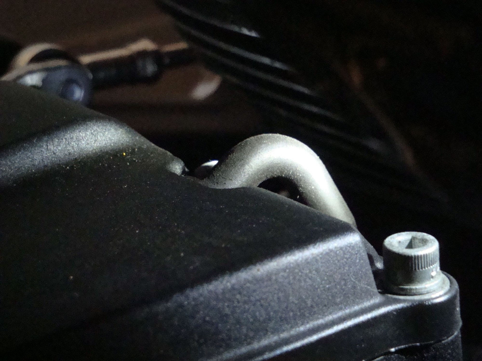

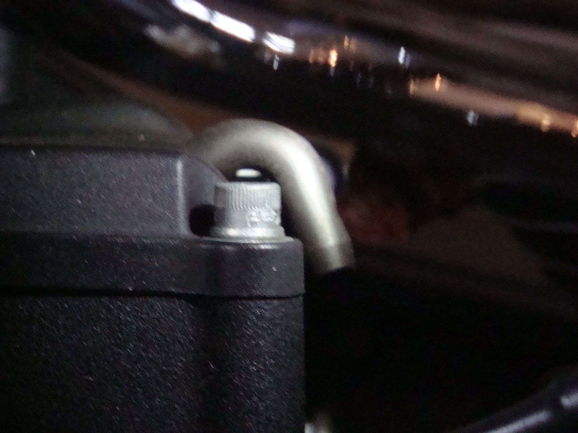

I've heard a lot about venting your transmission and crankcase. My 2019 FLSB has a hose coming from the trans. cover, pictures are on the right of bike just in front of dip stick right below the rear exhaust header. Is this a vent for transmission and/or engine crankcase ? Does this mean I don't need an additional venting ? Thanks all

that is the factory trans vent. The trask trans cover has another vent for engine crank case. Or you can add one for the stock cover.
