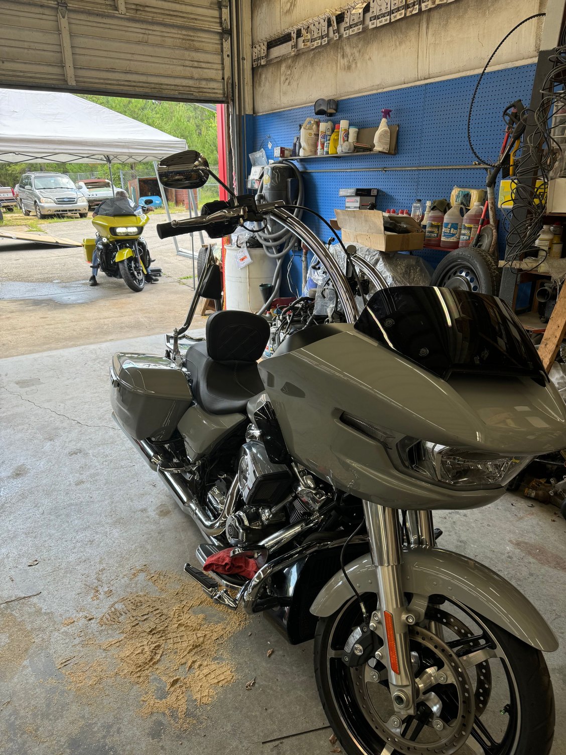

22” Cordova pull back handle bars
tab 50cal slip on with zombie baffles
cheap Amazon back rest 😅
so I want to run stretched bags but don’t want the factory fender to look weirds… will the previous year models fender bolt right up or is there some modifications that need to be made?

I suspect the old-style fender will hit the radiator cover but cannot confirm.

sorry I should of clarified… I meant will the rear fender bolt right up

Don't quote me on this but I thought I read somewhere or watched a video stating that the rear fender is pretty much the same as the outgoing 2023 model. If that's the case the old style bags should still word. I know Matt Laidlaw said in a video all the docking hardware is still the same and all the previous parts like rear back rest and tourpack still work.

it is the same other than that it is chopped at the bottom. It doesn’t have the integrated brake lights at the bottom of the fender which I thought was a much better look on the 23 and earlier bikes. I think the brake lights in the 24s are really bad looking.

It is the same frame and rear fork, so I don’t see why the old rear fender wouldn’t fit.
Apparently the bag support is different, but someone has already swapped over the bags and they work fine.
The low center run/brake light on older bikes was part of the filler panel, not the rear fender, so I wonder if that would just bolt right up to the new fender.
The rear lighting has different connectors on the new bikes so you’ll have to splice the wiring or de-pin the old connectors and put on the new connectors.
